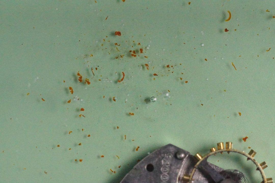

So, based on the fact that I did indeed get it running - it didn't run for long. Decided to focus on the balance and pallet and thought that swapping parts with the other movement was the answer. WRONG. Decided to put the original balance and pallet back in but had noticed that some rust had bloomed on the balance cock and hairspring. Soaked it in vinegar overnight and now it's stewing in a WD40 bath. I did however notice that the underside of the balance cock had the serial number stamped in to tie the balance to the main plate. Quite a bit of small rust flakes dropped off during the overnight soak. Also, this was shot using my "new-to-me" 100M28 macro lens that just arrived today.

Quite a lot of flakes came off...
There is a lot of rust coming away

Could be that the rust was holding it together! When I took it out of the WD40 the balance wheel dropped off the cock and there were two really tiny pieces which I realized were the roller and the piece that fits into the cock that actually holds the hairspring.
Tried to fit that back where it goes but as you might imagine it's about the size of a shoe that an ant would wear and it has to be oriented. So, I'm going to take a break while everything soaks in ONE DIP, squeeze my rodico and ponder a slug of Glenfiddich and Drambuie  or maybe some Woodford Reserve bourbon...

I'm wondering if the wd or the vinegar had anything to do with that. That would be the stud that holds the hairspring in the cock. The wd may have reduced some size of the roller. Anything rust removing could also have a tendency to also eat away at the metal as well, the soak may have been too long . I soaked an escape wheel in Rustins rust remover, it completely dissolved it in 6 hours. What is the condition of the hairspring now. This where you need a scope G. Have a look around for a cheap second hand if you don't want to buy new just yet. That will at least give you a feel for the difference in ease of use, you can always sell it on again. Rodico is an expensive stress ball matey, and no please don't turn to drink don't do it, things aren't as bad as they seem 🙂.  When I'm fed up I reach for a pack of biscuits because I don't drink, then I can go for a five mile jog and no harm done 😀

The pieces of the balance are spotless - including the hairspring. I just need to be able to put them back together. Yes, a microscope would certainly help.

That's good to know that the the rust removing concoction does work. If the hairspring is in good nick then it's unlikely that vinegar or wd would ever damage anything. Good experiment G That's a win for us beginner's don't you think 👍.  Newbies 1 - Pros 6452. Haha.  Yep mate put the bottles away have two more biscuits instead.
