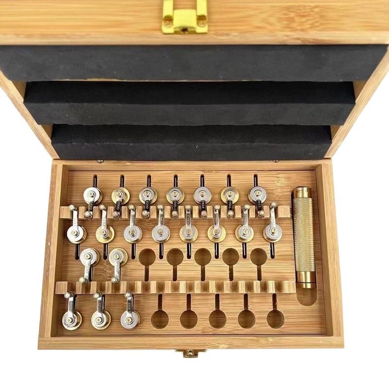

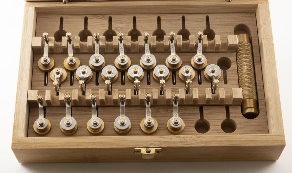

The obquous mainspring winder ser.
This set came from Aliexpress and the price seems to fluctuate around £150
https://www.aliexpress.com/item/1005002838742309.html?spm=a2g0o.order_list.0.0.21ef1802uk2ABx
A set of 20 winders with lrft and right hand sizes plus one handle.
With this set the important Arburs are all steel and they are sold steel throught the range even some of the bergeon ones use a brass core with steel sleeve on the larger sizes, these are all steel.
Construction and machining is all to a high standard

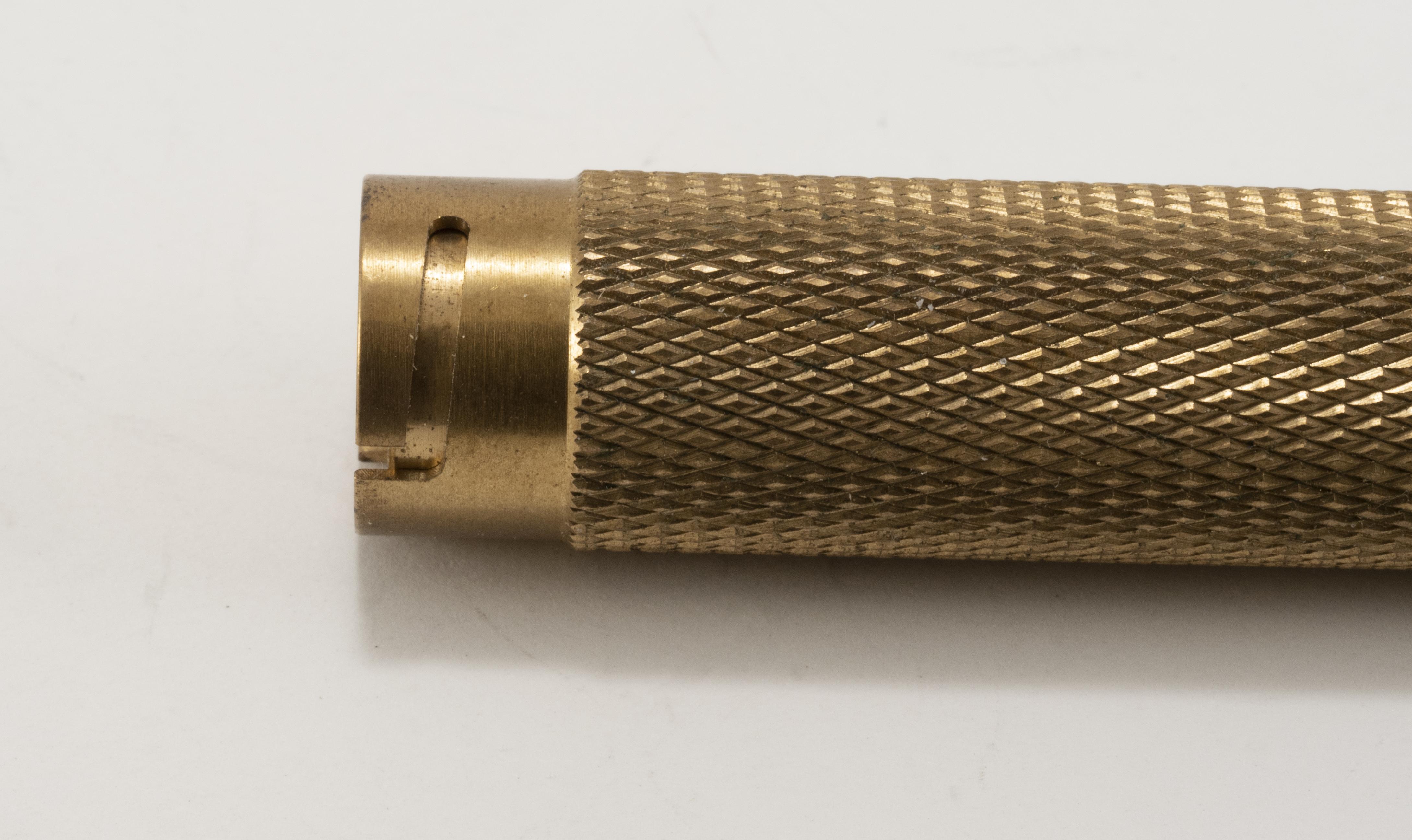

Now to the handle which is often a point of critisism in these Chinese sets as there is often only a right handed handle included which can make using the left handed winders a trifle fiddly which is why Bergeon supply two handle in their kits.
The handle in this kit is actually cut for both left and right hand use so only one is needed.
So on the whole a high quality tool that works well and well worth the average asking price of around £150.
Photos below, more tools to follow.

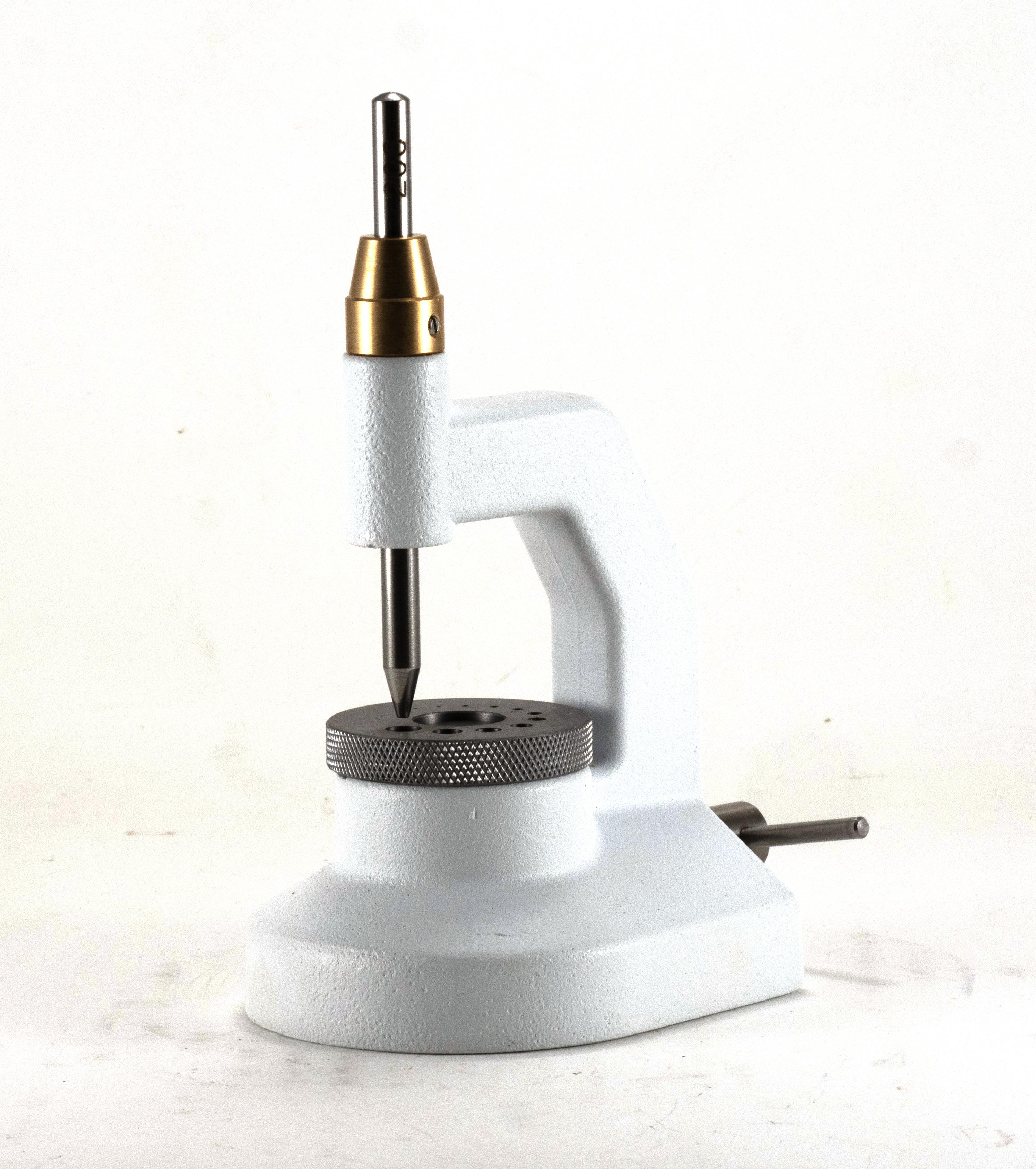

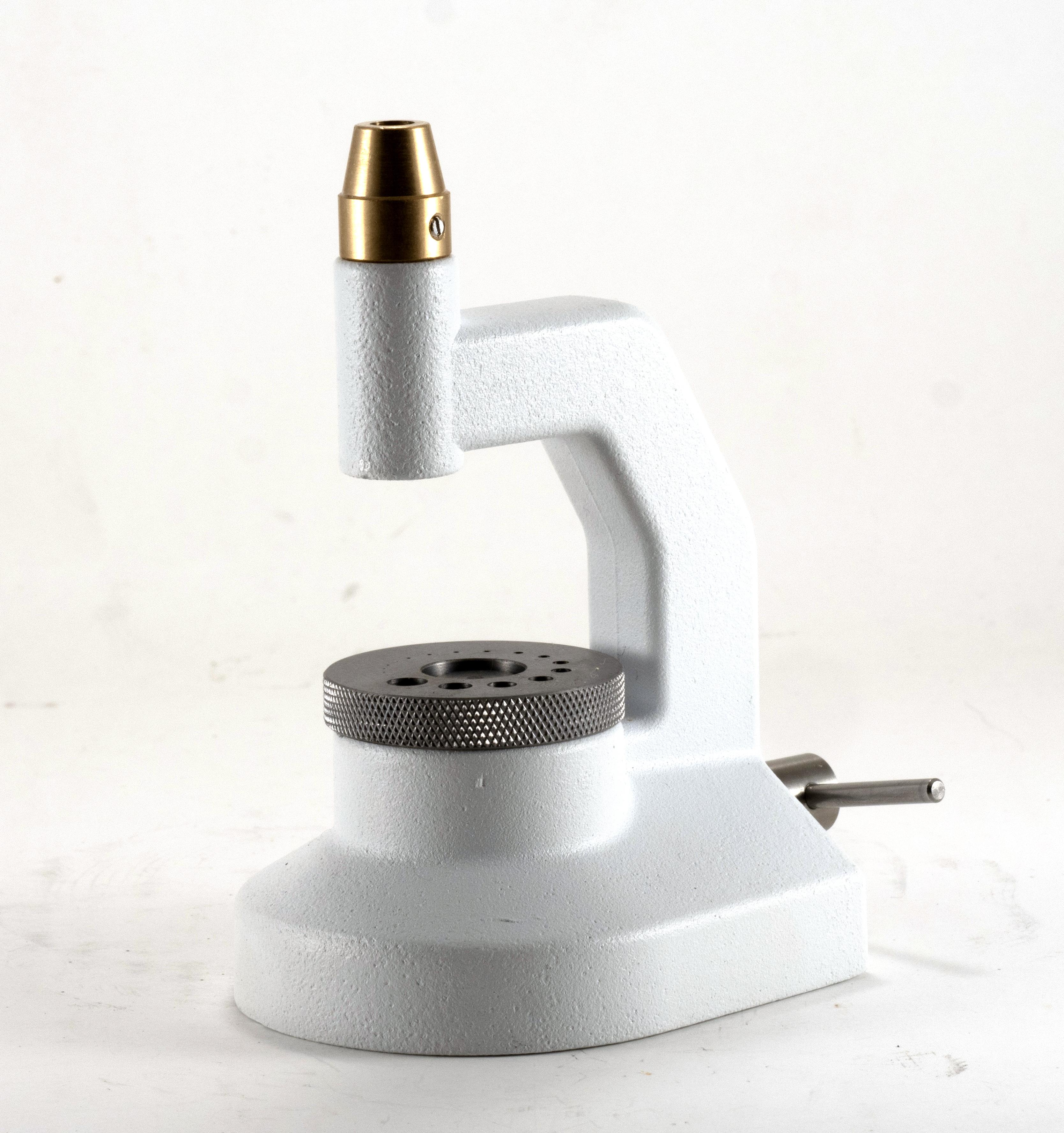

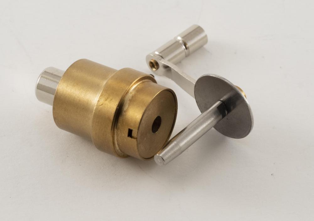

Next up is a Basic Staking set again found on Aliexpress
https://www.aliexpress.com/item/4000394566891.html?spm=a2g0o.order_list.0.0.21ef1802wHIXpx
A well made tool with 50 Stakes and 10 Anvils, all machines to a high standard with size code etched on each stake, codes seem to match those supplied by Bergeon etc.
Only used it a few times sofar but it did everything expected without any issues.
The only thing to note is that the Stakes cannot be used inverted, if that is an issue than something from Bergeon etc may be your only option.
Another Chinese tool I am happy to recomend.
The main tool looks good, that is true.
But the stakes? I can see only few usable ones. Looks like they copied but had no idea what to do with those. There seems to be no system of stepped sizes.
And 50 pc. is a very small quantity.
You would be much better off with a used non-chinese tool. For that money good, really usable ones with more stakes will be available.
Frank
9 minutes ago, praezis said:
.ut the stakes? I can see only few usable ones. Looks like they copied but had no idea what to do with those. There seems to be no system of stepped sizes.
Sorry, how you can tell from a picture? OP said sizes are copied from Bergeon.
It is a small set, these have always existed, target not too demanding professionals or people able to make their own stakes.
Frank

13 hours ago, Paul80 said:
Don't forget the idea behind these posts is to highlight quality tools for those of us less fortunate in our financial situation.  Just because some of us are poor does not me we have to use rubbish tools.
I forgot this not a second, Paul. Hence my advice above.
Do you own that staking tool or did you judge by pictures?

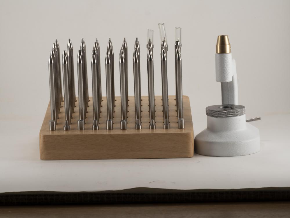

13 hours ago, jdm said:
Not really cheap, not Chinese, but looks good and no money goes to the Swiss
I knew these Indian ones, but don't know if still available. They are well made and usable, but stakes differ from the usual 4.7 mm - a drawback:
Frank
Frank
All the tools I will be showing have been bought and owned by myself
That is good to know.
Maybe you can post pictures of the stakes faces? As said, the Aliex pictures of them were not convincing to me.
Frank
Not easy to photograph just showing the tips so here is a list of the 50 included, the numbers match the Bergeon List
200, 202, 204, 206, 208, 210, 211, 212, 214, 215,
217, 218, 220, 223, 225, 226, 228, 230, 232, 237,
242, 245, 248, 250, 252, 254, 256, 258, 260, 262,
263, 264, 265, 266, 267, 268, 269, 270, 272, 273,
275, 278, 279, 283, 285, 287, 290, 290, 292, 293,
Regarding the picture you posted above, not seen those listed anywhere and looking at the prices, how old is that picture ? prices look like they are from quite a few years ago 😉
Edited by Paul80
£280 with 120 punches is good value but so was mine at £155 with 50 punches.
The important thing was I had £155 to spend I didn't have £280.
Anyone ever seen the likes of those seen in the picture above at anything close to $95 with 120 punches.
Punches or stakes what is the correct term as they seem to be interchangeable with some sellers ?
From the 2007 catalog of a Mumbai wholesaler who supplies Cousins and US sellers.
Frank
