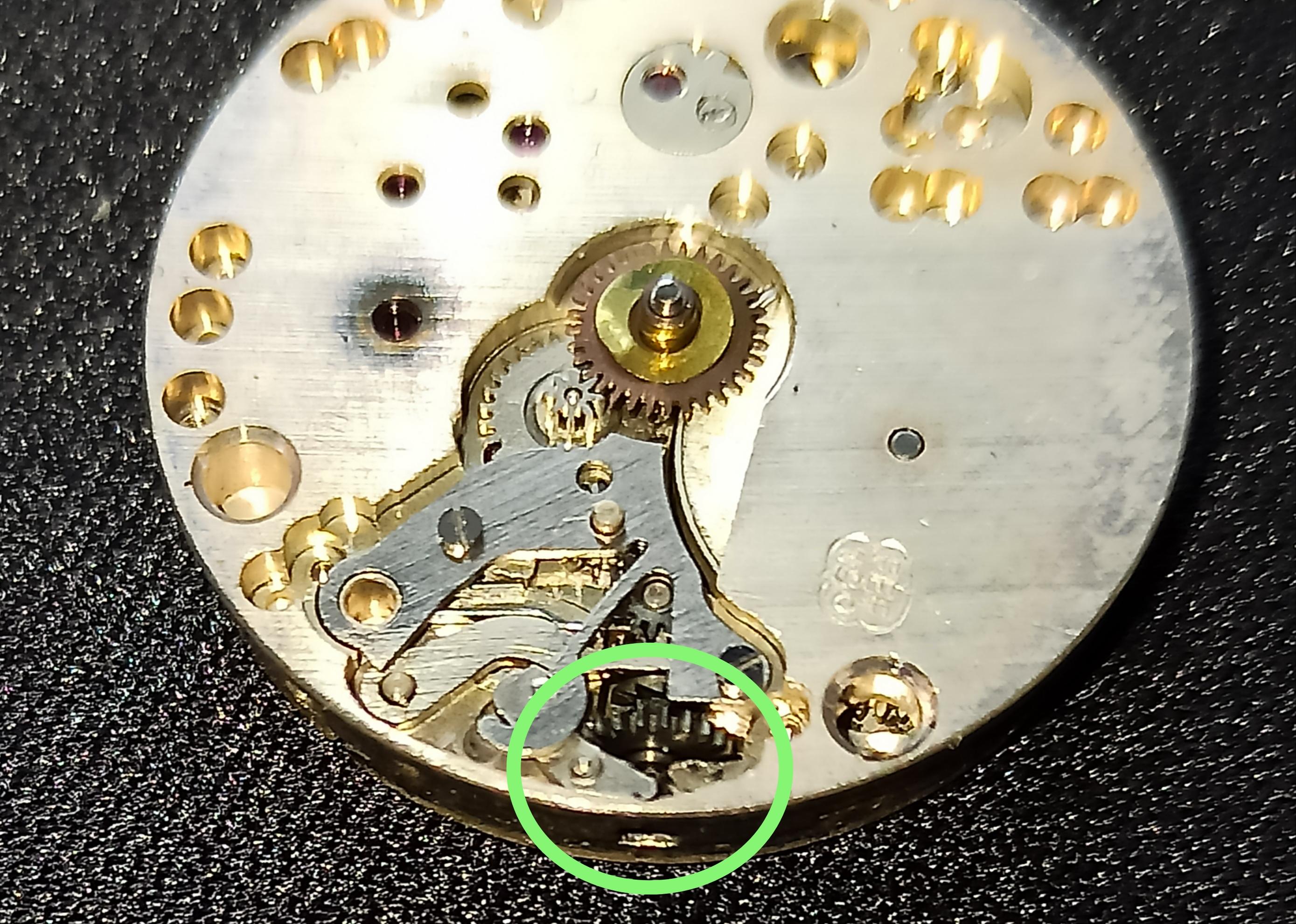

Thanks for your advice....got as far as getting movement out, but how do I remove the snapped but of the stem still inside. I have loosed the small screw that keeps the stem in place, but its not budging - I thought it might have dropped out - no such luck!
Tony
Remove hands and dial, push out stem from dial (keyless) side.
See images below - I'm not sure how to 'push' the stem out....there doesn't seem to be anywhere to push from. Additionally, I am not even sure I can see it....
Thanks again,
Tony
I seem to have extracted the broken stem. A little more fiddley than I'd hoped for my first foray into watch repairs. All I've got to do is put it back together. Is there any maintenance I can/should do before hand?

Ya, put all the keyless( sliding pinion, winding pinion,  etc back on, insert tbe stem, instal the bridge/ selector fork back so you have the stem in place, test if the set mech works right, lastly  put the dial back on, this way you have all the set mech aligned  cuz sometimes it all gets misaligned which wont let you insert them stem in and if you have sized the new stem all thats left to do is lower the movement into  the case.
