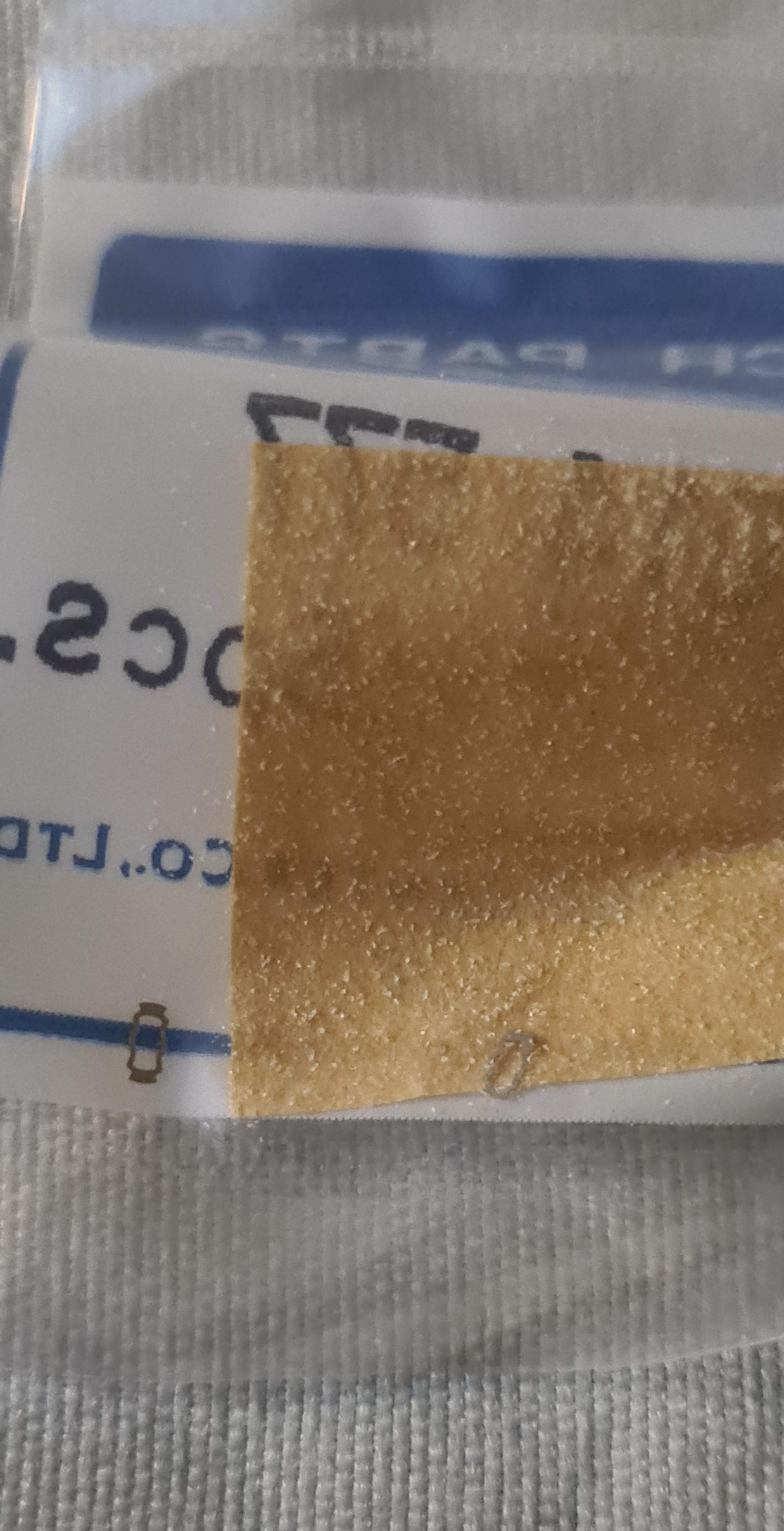

On 1/28/2022 at 1:34 PM, MaGa said:
Hi All,
in my first attempt of lubricating the jewels and lowering down agin the spring, i mess it up. The spring literally disappeared, I'm not sure where wanted to fly :).
Where i can source this diafix from? Anyone can help is super much appreciated. Thanks
This may help
7S26A_7S36A.pdf
Hi All,
  These springs numbered 014577 , they describe by seiko as SHOCK ABSOSBING SPRING .
