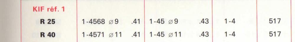

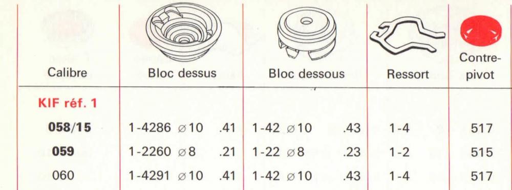

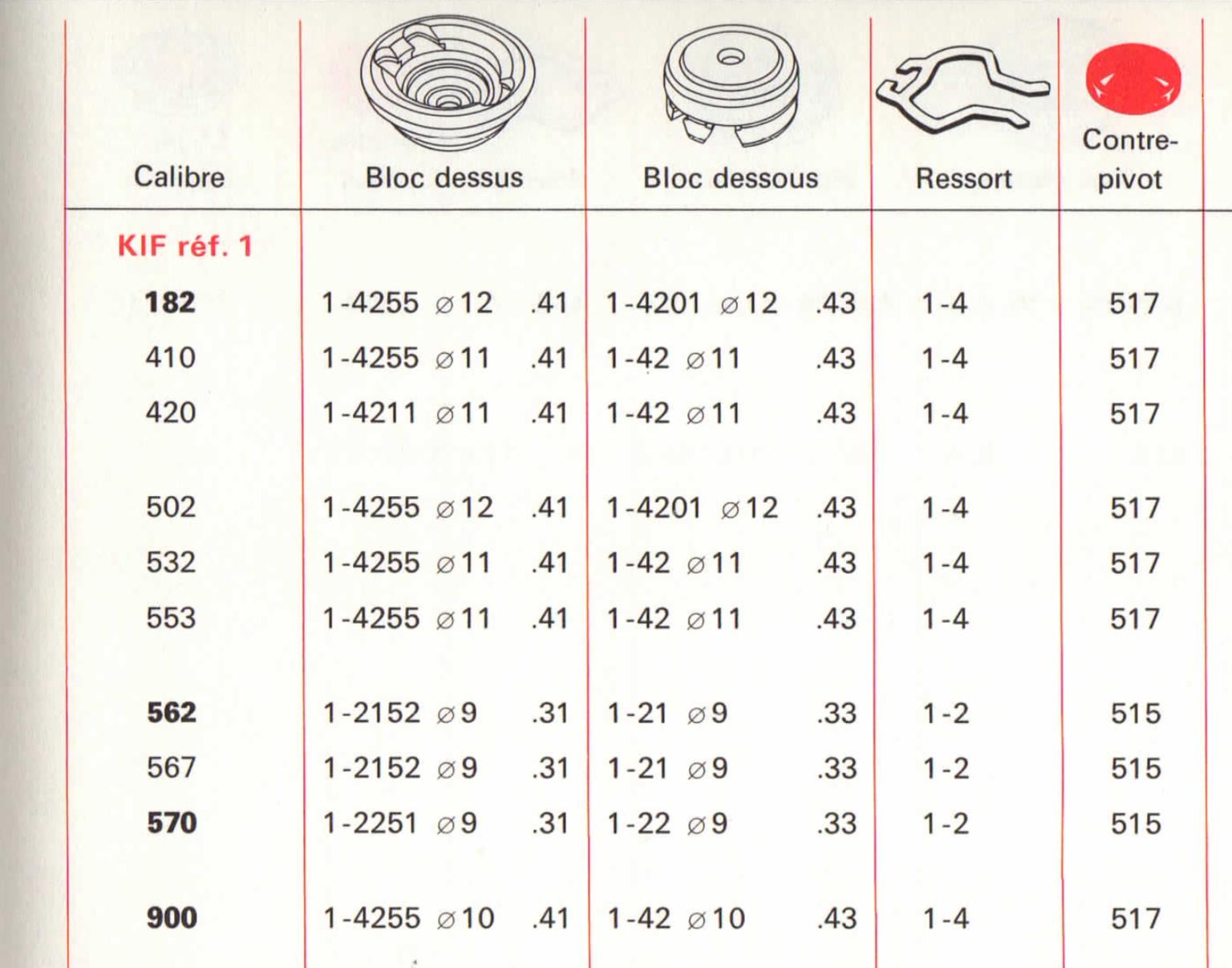

Thanks to @Plato for digitizing the KIF catalogue! After looking through the catalogue, I have come to the conclusion that KIF 1-7 is very similar in size to KIF 1-4, and may different only in thickness, or slightly in radius. There is no mention of KIF 1-5 in the catalogue, and it may just be a different color variant of KIF 1-4 or KIF 1-5, but I have no way of confirming this. The best way to identify the different KIF 1-X variants is to sort them by the cap jewel size (contre-pivot); the sizes of the shock block, or the hole jewels as indicated by Φ doesn’t seem very reliable as it seems the same shock spring can use a variety of shock blocks and hole jewels of different size. The only consistent measure of the shock spring is which cap jewel it is paired with, which makes sense as the shock spring directly contacts the cap jewel.
In the case of KIF 1-4 and KIF 1-7, they are all paired with cap jewel 517, the largest size cap jewel. KIF 1-2 is paired with 515, and KIF 1-3 is paired with 516.

As compared with KIF 1-4, you can see that they all share the same cap jewel:2C63B011-42A1-46B0-A071-B4F7D9D7AE66.thumb.jpeg.d3c4d197dd7bbe78f3f535e534b8d15f.jpeg1DABFC2D-59EA-48B4-B393-ABBD1E80ECDD.thumb.jpeg.5bd5d9f45aca80dc92b0a3b9f60623ba.jpeg8400AE60-E7D9-4C76-BD0C-4F11E1A83D98.thumb.jpeg.ff5492e1c12e502091474efb3e7669cd.jpegCF7E6933-ABBF-42D1-86B4-93508088B25F.thumb.jpeg.238f7f03b199fd748da5c905a740157c.jpeg240A5F85-9F01-4FCA-A71D-F74F09CA6C55.thumb.jpeg.7314fa830387867214b0801f1fc5abbc.jpegC9DA2243-F27C-4E14-A71B-EDE79CB4CE46.thumb.jpeg.1648f8275b2a5b1e17eeba8503216c6e.jpeg3172F27B-A505-4120-9D9B-9D2D5AD47FB7.thumb.jpeg.a65633ea67ac0cff43972d4ee7a92219.jpeg72F04D6E-7C67-481B-B51B-299E3E86A409.thumb.jpeg.7436a95e8f2748b9123e2919b05c30ce.jpegEEEAEAD4-FAB8-4331-A8C7-66027D88063A.thumb.jpeg.f315f15809ce149cc40cf594355f0bc9.jpeg9424D7BB-F4B6-4DE4-87F7-7663E44AF8E4.thumb.jpeg.937e5e24579df2311edd4cbf6b577b4b.jpeg8945C391-100B-432A-9BDB-937D31F69CCA.thumb.jpeg.fa736ee534a8d96ff9b2c229db83c267.jpeg421E91DD-224F-438B-A533-41E04DC9F783.thumb.jpeg.161dfa93b844322f003492a4fc9a6e28.jpeg7BB8E1BC-30E6-4F70-B742-5BF9EB02C171.thumb.jpeg.e911ebe5325a9ec95541b3b544ac2775.jpeg1263CB7D-EC7B-4D02-A0B3-115243C4B22F.thumb.jpeg.c0b12a300dca086f78bae9c9d19a35e8.jpeg
