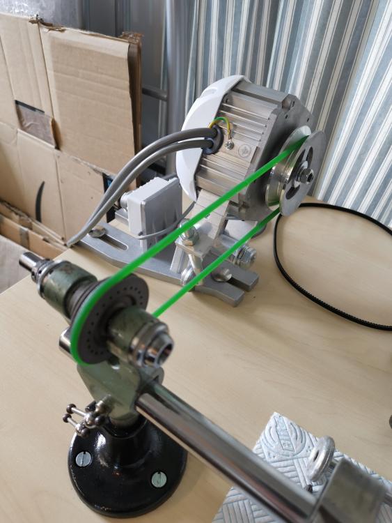

I recently bought my first lathe 😀 - only a cheap one (in second hand lathe money), just to get me started.
However, as I've never even been near a watchmaker's lathe before I was a bit unsure of how to get it running properly. I didn't want to post too many novice questions so I thought I'd just crack on with buying a sewing machine motor and hope for the best - I could always ask for help if I got stuck with something later!!
The pictures below show what I think is a fairly decent set up, for a beginner...
It's not perfect as the belt is too small for the motor and too big for the lathe, I'm working on a solution - probably a bigger v-pulley for the lathe. The black v-pulley in the background of the first picture shows what I used first, it ran okay but it was being torn by the lathe pulley. Also, the power cables could be better placed but they're a bit short for where I wanted to run them.

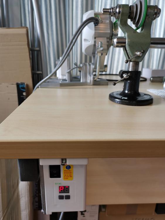

The motor is a brushless synchronous motor which with the aid of the controller (which I stuck under the bench) can run from 200 to 5000 (I think) rpm in either direction. This should save me from having to use different sized pulleys for different speeds at the lathe. The speed is adjusted between an upper and lower limit via the lever on the side (last picture) - I removed the original spring which was set up for use with a mechanical foot lever, now it just stays in whatever position I leave it.
I'm ready to start learning how to use the lathe but thought I should post my progress here first. PLEASE let me know if anyone can see something wrong with this set up as I don't want to damage the lathe or myself.

I agree with JD about the counter shaft, as this makes a big difference to keeping the torque whilst running at low speeds.
The countershaft will also get around the problem of the belt sizing, as pointed out by JD. I use the sewing machine motor belt to drive the countershaft and a rubber belt to drive from the countershaft to the lathe pulley. Job done!
I use the same set up and the counter shaft can be bought for about £100 to £150 which may seem a lot, but is well worth it, especially when running with a variable speed controller. One piece of advice I will give is, always keep the lathe and countershaft well lubricated, as it's easy to forget about it when you are concentrating using the lathe. I've caught myself doing it before and you don't want to run a lathe dry!

It's quite a powerful motor - 550W, so about 0.75hp - I was hoping that would overcome the issue?

It's more a case of having the space, I'm at the limit of what I can fit in already... but, if need be then I'll have to find room!

I definitely bore that in mind, Archie B. Perkins recommends clock oil so I used that before running it with the motor. I read 3 in 1 is okay too?

I had a sewing machine motor with a foot control on my watchmakers lathe. Not such a big motor as the one you are showing. It worked fine. You don't need hypa speed🤣 for watchmaking. Looks a nice set up.
The power of the motor has nothing to do with the torque at low speeds, hence the countershaft.
You can have a really powerful motor, but when the speed is low, so will the torque

3 in 1 is too thin in my experience and opinion, but ask 10 watchmakers about oil and you'll get 15 different answers... lol

Does that apply to this motor? The older induction motors slowed down by reducing the applied voltage (I think), doesn't a synchronous motor just reduce the speed of the rotating magnetic field? The torque should stay the same. It's basically the same type of motor used in cars now.

Jon is correct. With small motors, AC or DC, induction or permanent magnet, low speed means low torque. The only partial exception is with 3-phase motors used with a VFD inverter. But even a small 200W 3-phase is too big for a watchmakers lathe. In the end, stepped pulleys and countershafet were, and are the way to go.

I wish I had a better background/understanding to explain. It's a synthesised 3-phase motor, all of the power is applied at any speed. Are you thinking of the ac/dc universal motor? The one I'm using is not the same technology, it's the one used in PC hard drives, Dyson vacuums, Tesla cars, deWalt drills, etc.

Sorry I did not read well the initial post. Do you have a product link? I think on a watchmaker lathe there is really no (lack of) torque issue with either old or new technology motors, so this one might be a bit of overkill but if it works and is affordable that's all good.
The reason why I am fixated on torque at very low speeds, now going a bit off topic, is because when threading or even plain turning a 90mm dia work on a micro or mini lathe, brushed DC motor and PWM controller simply won't do. Even traditional 3-phase motor are going brushless, but at this time they cost 4x more. I am in this conundrum and was thinking to get a cheap low speed DC motor which is directly usable on my 250mm lathe, but at the time it lands and clears customs is not that cheap anymore. I see there are now brushless DC kits upgrades, then again quite expensive.

For 4 mm brass rod, try turning between 800 to 1200 rpm. It's more about the feel of it that will tell you how fast to go, as you may find it better to turn at a lower speed, which will cut just as well. Brass is more forgiving when using a graver.

Google "JACK Low Energy Silent Servo Motor - Industrial Sewing Machine Motor - JK513A", I'm using my tablet so it's awkward to post a link.
