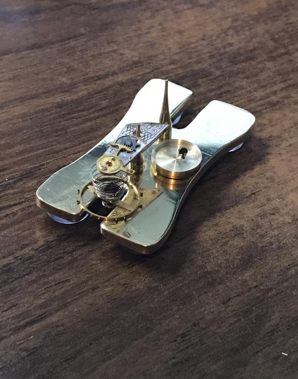

My tool

@jdricharddid you make this tool??  Very cool.
I did:)  Also added the leather for soft landing and lowered the tack to have the least pressure on the hairspring....+ two tacs
