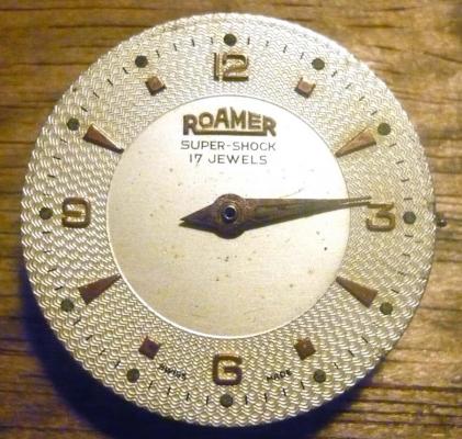

Finally, the pictures that I said would follow! I had to wait for the watch to arrive and then I was away for three days so came home to this in my mail.
The thing that attracted me most to the watch was the dial.
The Breveté case system is interesting and attractive too.
Of course, the movement was the dreaded MST 372, which meant that my comment to Geo about avoiding them went straight 'ootra windae'!
All that's missing is the crown/stem.
Also in the post was a dial/movement from a later Roamer, an MST 452 15 jewel job, had for the usual pocket money. Dunno what I'll do with it but it'll be a good practice piece. The crown/stem is present but is neither winding nor adjusting. Haven't yet investigated.

I really like these patterned dials. I was prompted to dig out the first watch that I bought after I got the bug (as opposed to those that I'd bought over the years for daily wear), a Melbun watch with a 25 jewel Felsa HM 1560 movement. That was bought on the strength of the dial but as a non-runner. I have learned a lot since buying it and considering it a junker so I took another look inside and gently removed and replaced the balance cock. This did the trick as she started to tick, and is doing so as I write after 30 minutes.
It's another one that needs a stem but I have the stub of the old one that had broken off in the tube. I hope that finding a crown and stem for the 372 movement won't be as hard as you discovered Nad.
Ah, I love these early Roamer watches - that dial is very sweet.
You often see Roamer watches advertised on eBay as "Breveté" models - when all that "breveté" means is "patented", in French. The serial numbers on the outside of the case back indicate the variations on the movements over the years, and this is useful in dating the watch. I recommend this excellent reference site:

As you'll all have seen, one of the hands needs reluming. I'm half tempted to leave it as is though because matching the new lume with the old might be tricky. Also has anyone any idea about what material the numerals and stars (love the stars) might be? Lacquered brass, gilt, Sta-brite? If I can clean them they'll look stunning.
