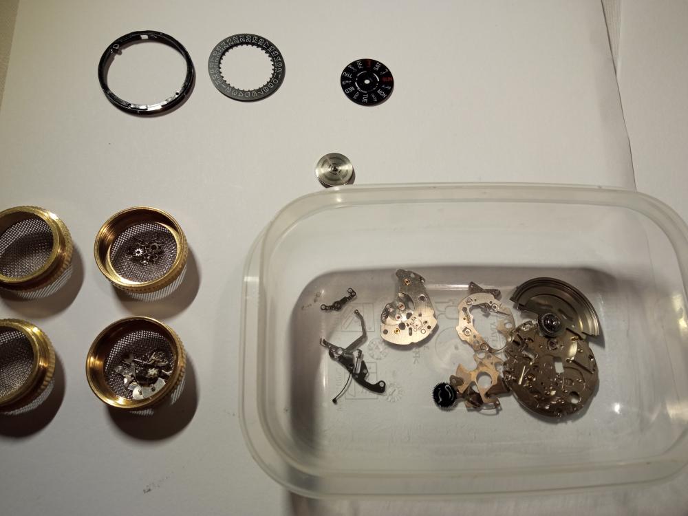

Hi, I don't have a zero value watch, but I do have some mechanism without balance spring ( I have ruined it some weeks before :).
So I kind of disassembled the 4R36A and my question if it looks ok and can I use ultrasonic cleaner to clean it, even thought I don't have any oil or grease yet. Meaning if I put it into water and then just dry it without oiling, might it catch some corrosion ? If I am talking nonsense, please let me know ?IMG_20210510_232731.thumb.jpg.def23968c95fef051b11bba080b6adf9.jpg
If you dry the parts blowing air while in the thimble basket, then on absorbing paper there will be no corrosion, and for testing watches run just fine even when dry. Water alone is never used to clean watches, but demineralized water can be used as rinse between certain other solutions, have a read of the topic below.
Still, in general you are talking nonsense. Everyone is free to do as he wants with his property, but if you come to a repair forum don't expect to be anything but the proper way to do things. However your problem is not about oils, clean, dry or what else, is being able to put it back together a watch, have it working, and stop ruining. For the best chances put the 4R36 aside, get the tools, subscribe the watchfix.com training already suggested, at least get into understanding first how each part is called and what is its function.

Actually it was of my kid. He broke the glass of the back case and watch stopped to work.
I have dissembled it until I have found the glass particle that I decided stopped the watch and tried to assemble again.
But for some reason, when I installed the balance wheel, it's didn't run, so I played with this until broken ?
Anyway, I ordered new mechanism, and already replaced, cost me 33$ NH36A, and it looks OK, still waiting for new bottom case cover to arrive ?
Thank you for explaining, knowing that would have saved the lecture above. Now you can try to put that mov.t back together but the most delicate part of that is handling and even refitting the balance. A genuine Seiko balance complete cost little less that the complete mov.t as you bought. The are Chinese ones are cheap but not 100% guaranteed to work good. Whatever the route you take I hope can get it working, good luck.
