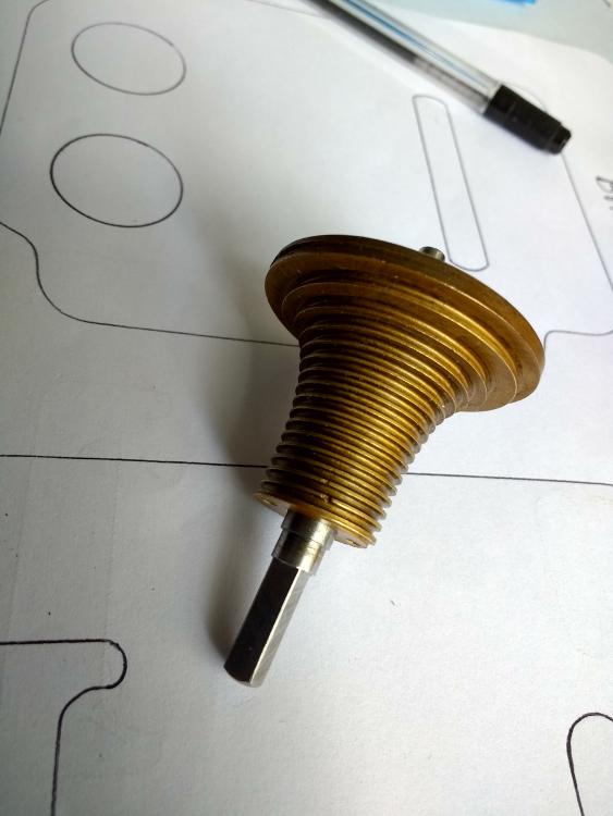

Don't know if you can see clearly on the photo there is two small chips out of the fusee do you think it will cause a problem when i come to assemble the clock.
No they wont be a problem there is nothing to prevent the gut line from following the grove in the fusee.

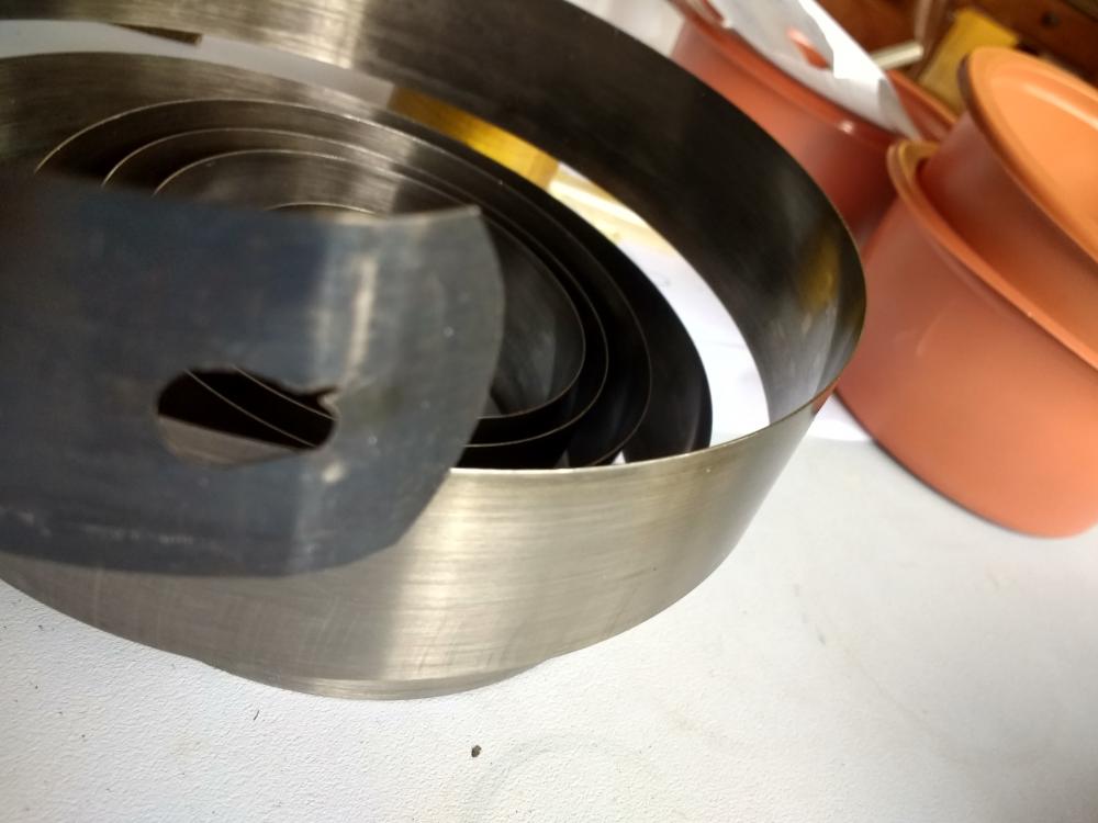

Decided to take the mainspring out of the barrel today to clean and inspect it, i noticed a crack in the end that attaches to the barrel when it came to releasing the spring, the end came off and went inside? i then went against everything you are told not to do and ended up taking it out by hand?taxi on hand to take me A&E but didn't need it it came out fine must say my heart was in overdrive.
1 hour ago, oldhippy said:
You will need to replace that spring with a new one. That is what can happen when you remove a spring by hand it doesn't rest flat.
Yes have been looking at companies  they seem to want different measurements counsins want the dia  as well as  the length,thickness and width the dia is that the dia of the barrel
Yes the Barrel. Make sure you have the hight as the caps just snap on, a little under won't hurt.  You certainly do not want it coming above the tiny ledge that stops the cap from going right in the barral.
