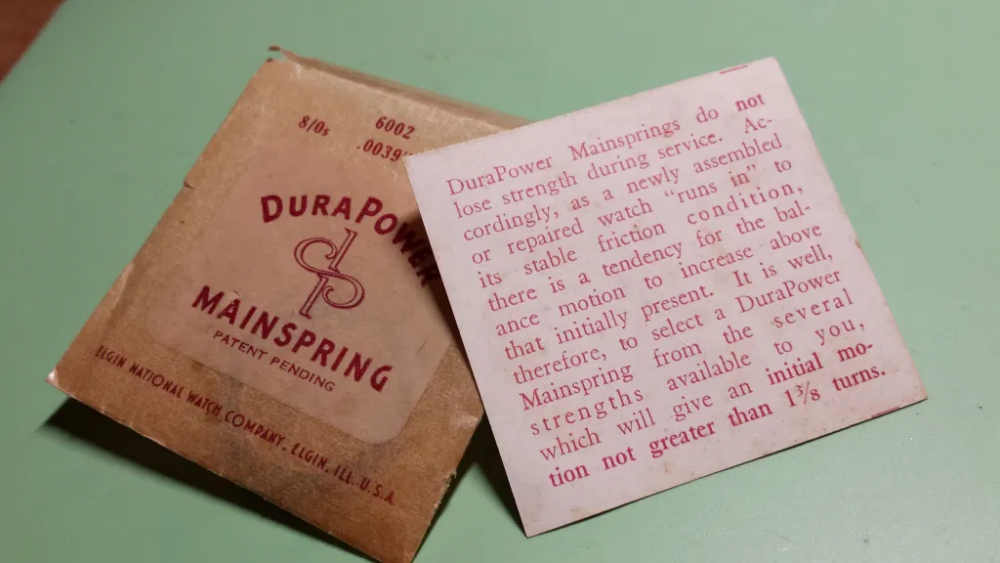

For what it is worth, Elgin, inventors of alloy mainsprings with their innovative DuraPower alloy in the late 1940s, argued that these springs had a break-in period. Several mainspring packages came with an insert noting that the amplitude will be higher later on after the settling period.
There's much to be said for letting a watch run for at least a few days before adjusting it.
