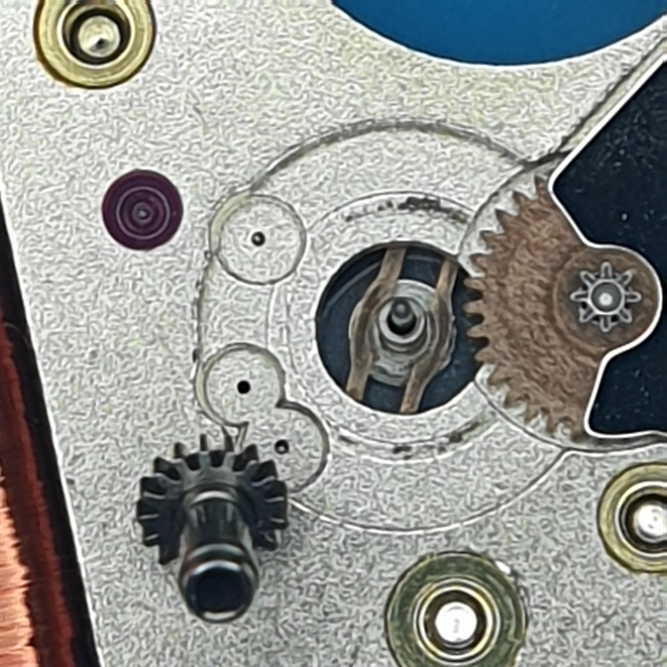

It was supposed to be a simple job. Just replace the battery...
But then I noticed there was a speck of dust under the crystal... So I took out the movement to clean inside the crystal.
Then I noticed the minute hand wasn't centred on the hour... So I removed the hands to realign them.
Then the minute hand stops moving... I took off the dial and discovered that the cannon pinion popped off when I lifted off the hands. ?
Now I will have to do a full disassembly to fix it. ?
I have to stop being so OCD.
Friction pinion all fixed up and reassembled.
On further thinking, is this a design weakness? If the minute hand is fitted too tightly,the chance of the pinion separating from the wheel again is very high.
Or is there a safer method of taking off the hands?

Or. . . next time just replace the battery and walk away LOL
I think we have all slipped down that rabbit hole many times. Glad you got it sorted.
IMO when such things happen, I look at it as an opportunity to learn more about the watch; as you have done. Most fo us have an extra watch around to wear while something is in process.
