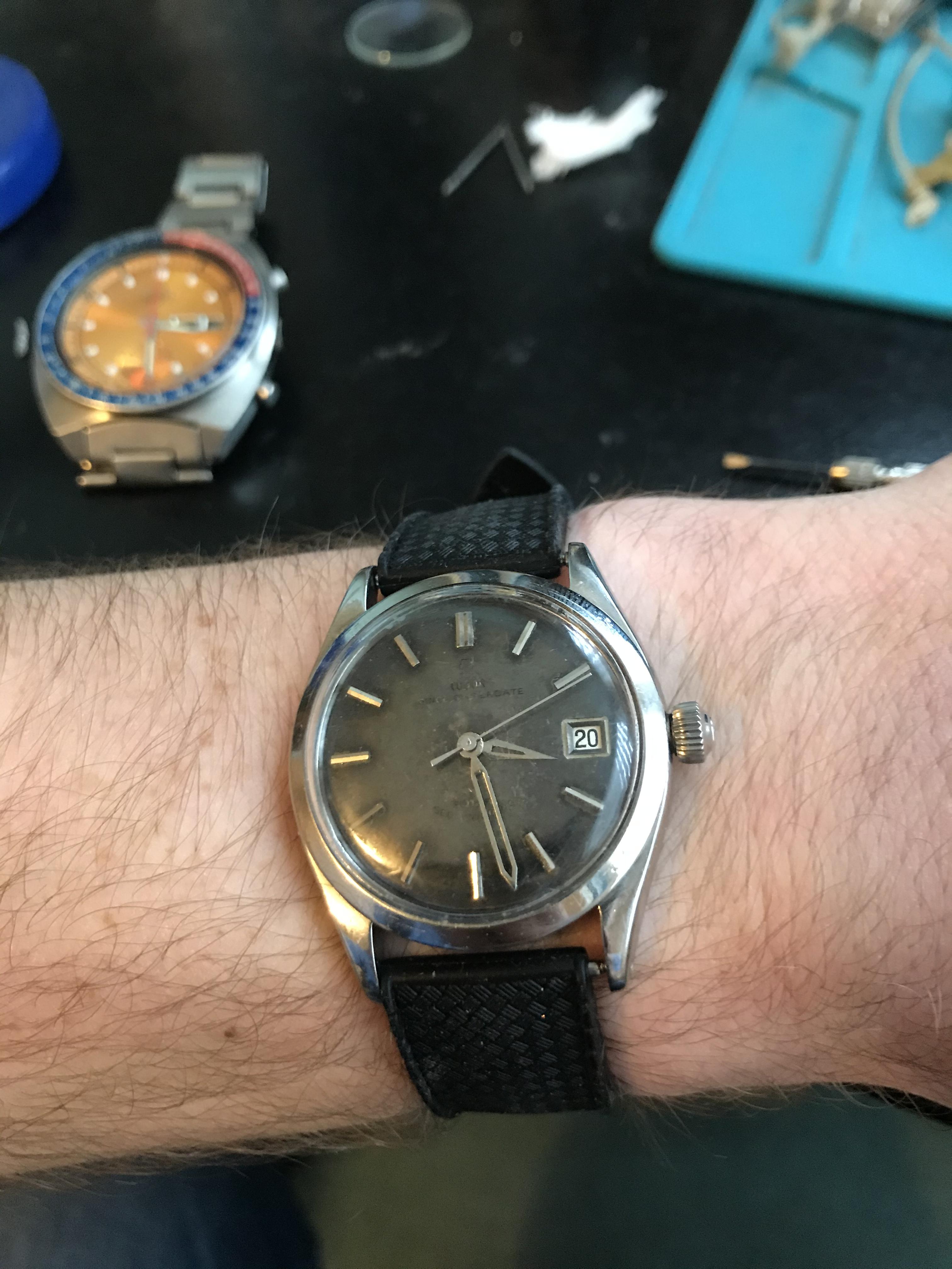

There is always the option of refinishing the dial, but think it through first. There are some with strong feelings opposing refinished dials, preferring the original regardless of the "patina" it may have. Generally, higher end watches will decrease in value if the dial is refinished.
And cleaning this dial will not improve the appearance significantly.
The print is missing.
re-luming the hands would help, but note that the minute and hour hands are not currently matching types.
Actually repainting the print on a patina dial is a (good) idea I hadn't thought of. I'm sure a dial refinisher could do it if they wanted to. Print in white of course.  I'd contact them first before sending it off.
