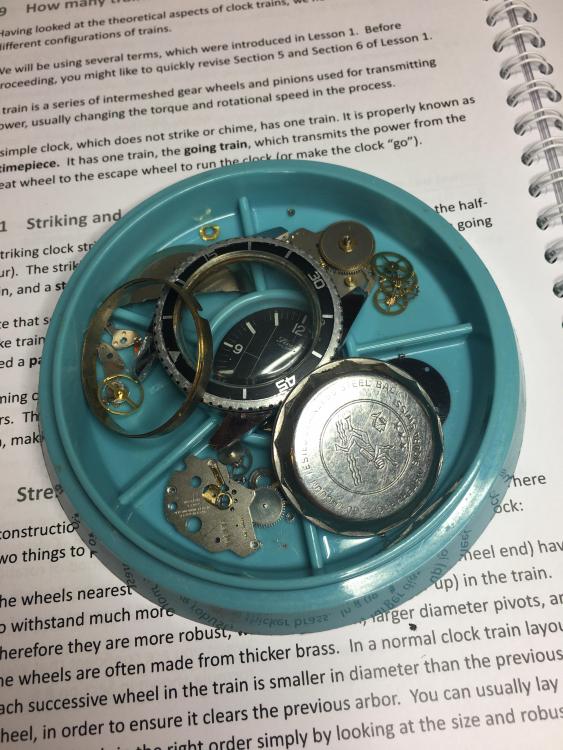

I have one of the plastic compartmented bell jar jobbies. I keep works in progress on movement holders in it on my desk under my tool tray. I started out using it as above, but I wanted more separation and security.
The aluminum/glass pot trays are my preference. If you knock the tray, or the desk, or whatever, things stay contained. One tray is enough to separate a typical automatic movements out by plates/systems; two would be required for something like a chronograph. I've also occasionally used the lids as flat platforms to get things off the work surface a little. My desk has a drawer slot that will neatly fit a dozen (possibly 16) of the boxes, so I could have that many in progress at one time (eventually).

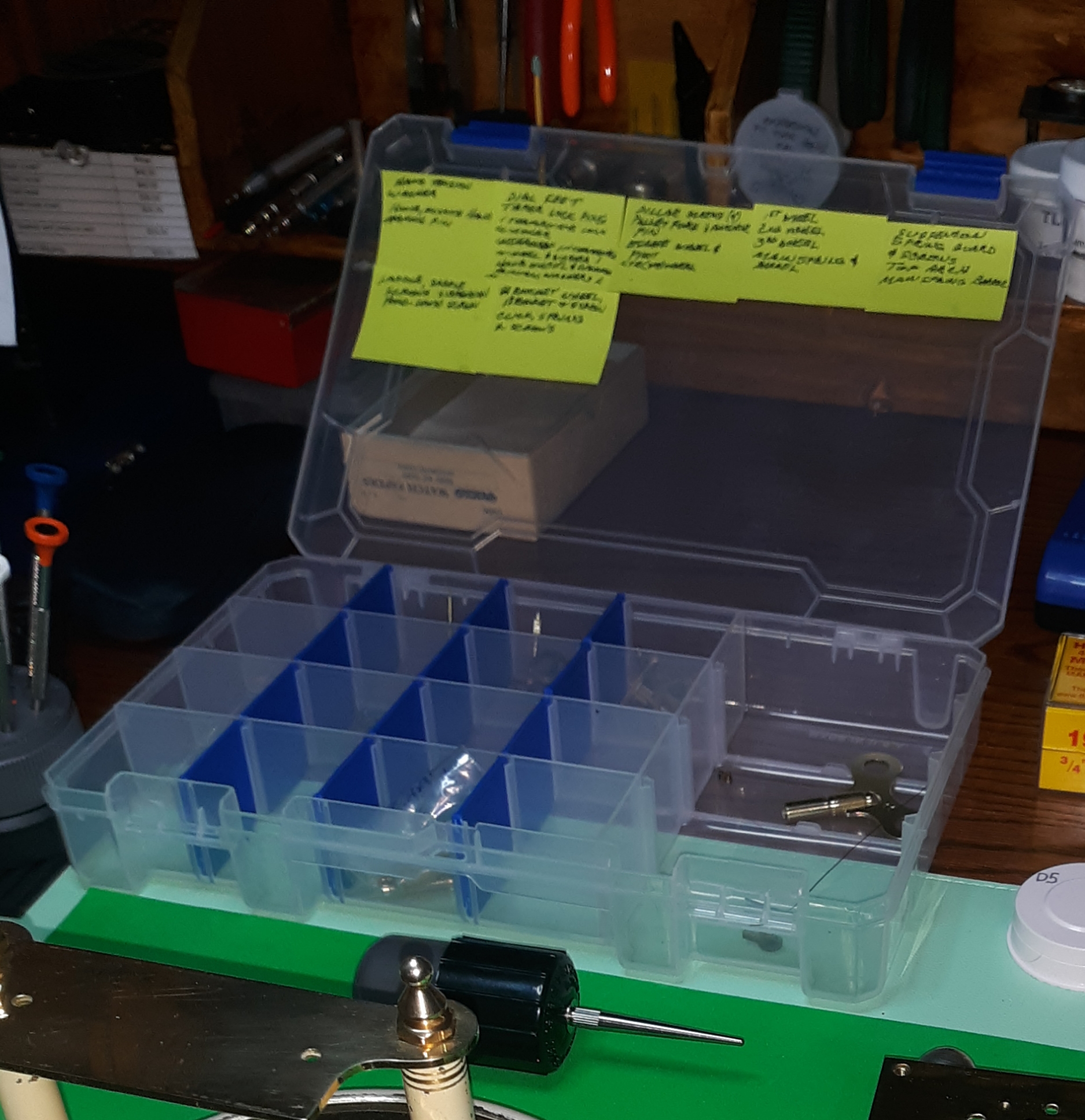

I have used the little plastic pots with plastic top too. Still do for certain jobs. And I have experienced some static cling. But I find myself using these bait trays from Plano $2 USD more often and they are sold as static free. They work.  I add little post-it notes for part ID and I too, take tons of pictures who I then give to the owner as part of the description of what was done to the watch. People seem to like that and are fascinated by what I explain combined with the pics I give them. I put the pics on a flash drive and give it to them.  Most say they've never seen anything like it and never thought twice about what goes on inside or what it looks like. Love their reactions.
The trays and dividers are adjustable.
