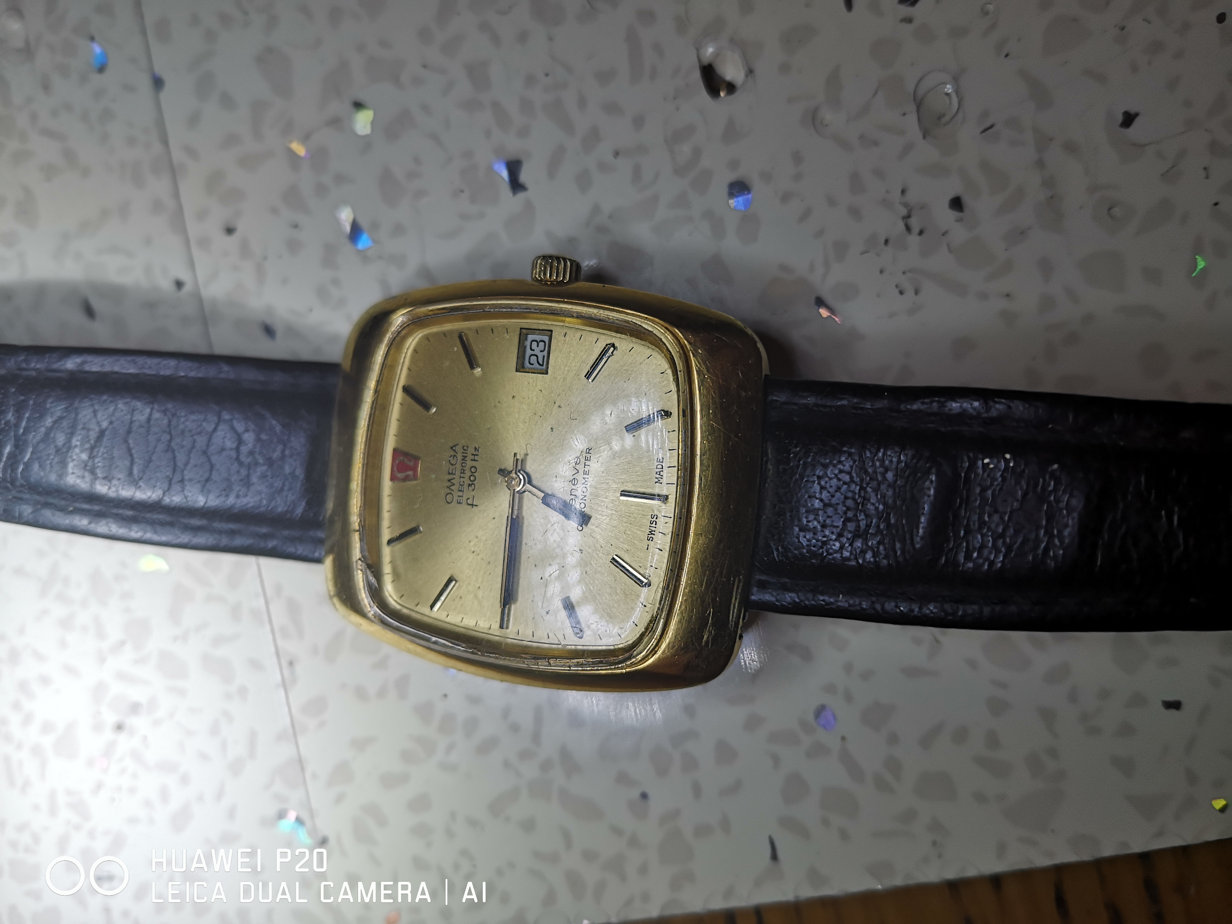

How do i find out what glass will fit this case.
Case number is 198.0062.159.
Entered that in google and cousins and nothing.
The glass on it has a small chip in corner.
Also what does megasonic and the initials ST and MD Mean in context to this watch?
any help as always much appreciated.
cheers
gary
You need a Omega part number PZ5260 they come with either a steel tension ring or a gold one :
http://www.ofrei.com/page_168.html
https://www.ebay.com/p/797864642
There not cheap.
The tuning fork movements where  patented by Bulova so any watch company producing them  had to do so under license  9162 is the calibre number of the Ebauche (Basic movement) supplied to Omega which they would have then finished to their own specification.

Thanks a lot but mine is square.
I am going to sell the watch but noticed a nick in the corner of the glass. You cannot feel the nick but when held a certain way you can see it.
Its a odd one this. Its a omega f300 hz geneve chronometer with a cal 1250 most i can find are cal 1220
and its 1973 besides that nowt.
see pic
cheers
gary
