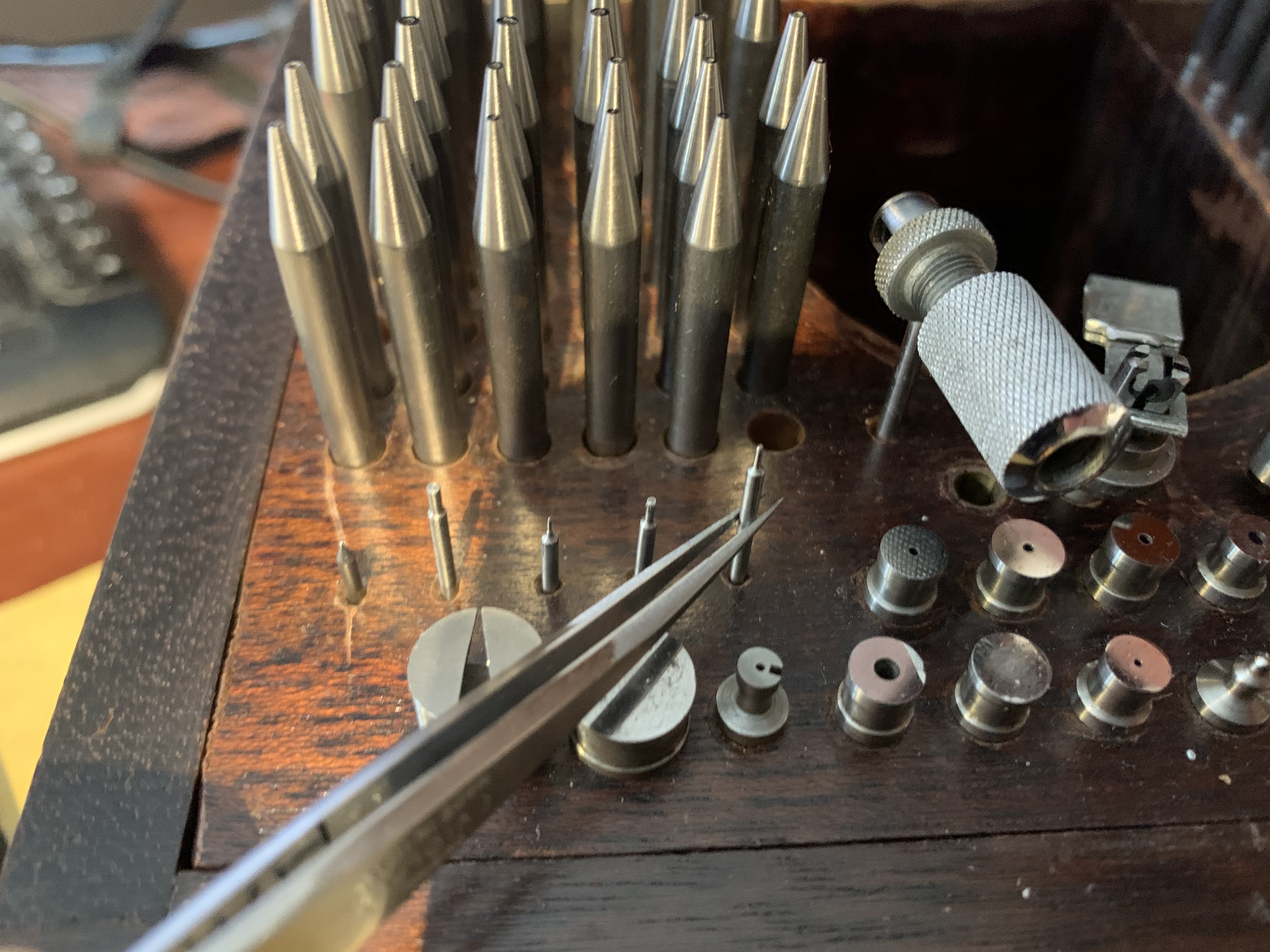

I bought a new centre wheel for a Seiko Bellmatic and it came fitted with a cannon pinion.
How do I safely remove the cannon pinion ?
I tried pushing a very thin broach down the centre, but I had to hold the cannon pinion in tweezers. It didn't work as I didn't want to squeeze too hard on the pinion.

Improvise, and be creative with K&D tools - use a thin plate between to avoid direct contact with the wheel.
Of course NOT every punch will work. Again, improvise. See the photos below - that's how i removed similar stubborn cannon pinions. I even used this method to remove Central Hand on 7753 ETA when no other option worked due to extremely tight fit. No damages, no scratches, no bent parts, and it took a few seconds. Good luck.

Actually you are NOT going to bend the wheel if you place it flat onto Staking Tool Table (or Anvil) using large enough hole, suitable just to accept the bottom pinion.

You are reading it wrong. Staking tool die or anvil with a suitable hole was suggested for use in conjunction with Hand Removal Tool.

 The only way a staking type tool would work would be a Platex, where the wheel can go in a thin V die, supporting the bottom of the canon pinion, and tap the center pinion through. One of the only useful things about a Platex in my opinion.
K&D staking tool has a perfect equivalent attachment, similar to Platex

Take a look at the pictures. This is not an identical wheel, etc, but it gives you better idea how to use Hand Removal Tool in similar situations without bending anything. You are not going to deform a staking tool die, right?

That's exactly what I did, and this is why it can damage the wheel :
The force you apply by either levers, or hand pullers, at distance 'x' from the centre, has to be reacted by the wheel spokes. I believe there's a good chance they will bend before the pinion releases.
I tried under a microscope, and could see the centre of the wheel start to distort, so I stopped.
Two comments:
- it appears that you missed my comment above about using a thin plate between these surfaces. I made several such plates resembling to Dial Protectors, but using thicker plastic (guitar pick) and metal. The idea is to prevent dents and to hold down the entire surface of the wheel (similar to K&D staff removal tool / attachment which pushes the balance wheel down while staff is being knocked)
- my preferred method requires some good eye-arm & don't breathe ? coordination just for a few seconds while delivering one punch using a fine punch shown in my previous posts. No staking tool die, just two hands. You will be surprised how effective that method is.
But the most important thing is that you were keeping everything under control and STOPPED as soon as you noticed something was about to go wrong.
Congrats!
