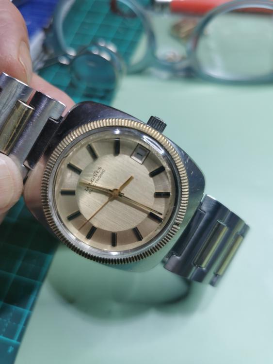

This one is a dress bezel looks the same but broken ? I will glue this one
Yeah very similar. So is it the bezel that secures the crystal? Or are they both glued?

Crystal was put in with crystal lift, bezel is snap on over small lip on case.
Ahhh! Mine has no lip on either the bezel, the case, or the crystal.
