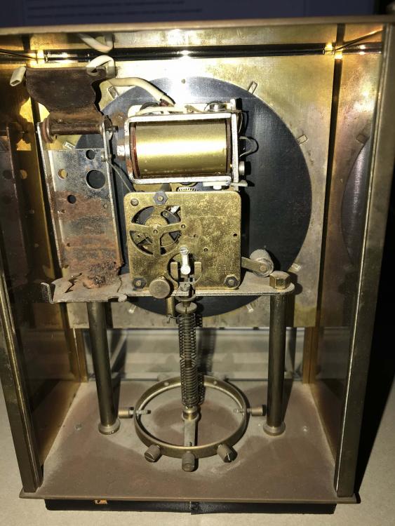

This time I am going to throw myself at the mercy of everyone because I have a brass clock that my Grandmother owned. That makes it over 58 years old. To be honest I don't know how long Gran had it before I ever knew about it.
Anyway, it stopped a long time ago. Why, you may ask?
The movement is kept going by a battery which triggers a very simple electromagnet when a small weight gets to the bottom of its fall and returns the weight to the top and then the weight powers the movement again as it falls.
Battery. Well we all know what happens when batteries are left to their own devices? It had leaked and taken all the chrome off the battery holder. The spring that held the holder tight against the battery also succumbed to the battery goo. The rear door is steel. The battery goo made its way down the clock into the base and then over to the rear door and made a mess of that as well. The little catch that the door had to open and close it was sort of riveted into a single unit through the door. It has become two parts. In my haste as a younger man to beautify, I removed the paint from the clock face. THAT was probably the stupidest thing I have ever done.
I am thinking now that I will mask all the hour markers and repaint the face to the pearl colour that I remember it to be.
What I loved about it and spent many hours watching was the, and here is where my ignorance shines brightly, the part of the clock that oscillates back and forth in the bottom of the clock behind the glass where you can watch it turn one way, stop, and then return the other way.
I have looked online but can't find a picture of this particular clock. I have included some photos for you guys.
Is there anything n particular that I need to be really cautious of as I embark to return the clock to what it should be like?What sor of amplitude should the 'bslsnce wheel(?)' have?

Hi What an old beauty that is with the double Helical balance spring, never had my hands on one but suspect they operate like the 400 day clocks with a 360 rotation plus a little overdrive. The following link hs some info  http://www.mridout.force9.co.uk/ecw/hettich.htm#:~:text=Hettich&text=The Hettich mantel clock has,movement is a pin pallet.&text=Thus%2C as one part eof,move in the vertical plane      Timesavers in the Usa have some Hettich parts see link    https://timesavers.com/c-1158728-clock-repair-replacement-parts-balances-escapements-components-balance-forks.html

Hi Michael   Its a clock whether it has a battery or not. I repair Quartz clocks and watches no problem but I understand some people dont like them. I stripped and repaired a quartz movement just yesterday, It was a wedding present and held some sentimental value so therefore worth doing in my opinion.   The Hettich is an unusual clock and yes I would restore the dial to its former glory, Handle the balance and spring carefully as I don't think there are replacements except from scrappers and I guess they are scrapped because the spring was damaged. Carefully dismantle and clean the mech. From photos I have seen of these clocks they look good working away just like a 400 day the balance rotation is mesmerising.     There was a post on the forum from TMuir a fellow Australian from perth , on one of these clocks so have a look through the search function at the top right of the home screen   Nov 6th 2016 was the posted date.    best of luck and take care.
Now I am a bit wild with myself. Could I have fixed the issue that was in front of me when I was given the clock? I don't know, but what I am fairly certain of is that the clock was gilded brass, with the rear door (steel) painted black.
The leaking battery had made a mess of several internal parts. The gilded brass and the chromed battery carrier. The insulated spring that held the battery cover when a battery is in it was also destroyed.
If you have a look at the picture from the rear of the clock and specifically at the hexagonal head on the right column, that may indicate to people far more knowledgable than myself whether it is gilded.

I've restored one of these clocks, same brand but different style, mine was in a glass dome similar to anniversary clocks.
Be careful with the pendulum, besides the obvious double helical spring it has a jewel in the top of the rod that the wire passes down through and a sideways jolt to the top can crack the jewel.
If the wire breaks that holds it up go measure it and you will find that the metal superfine guitar string will be the perfect size. I think it is the 'E' string, but a quick measure of the broken string will prove that.
Also be aware that the copper 'hairspring is also the electrical contact to energise the relay.
Yes it is battery powered but in essence all the battery does is lift the weight, so in some ways its no different to a tower clock that has had sensors fitted to the rope for the wight that triggers an electric motor to wind the weight back up. Yes this make the tower clock electrically powered but I don't think anyone would dare say it wasn't still a mechanical clock.
