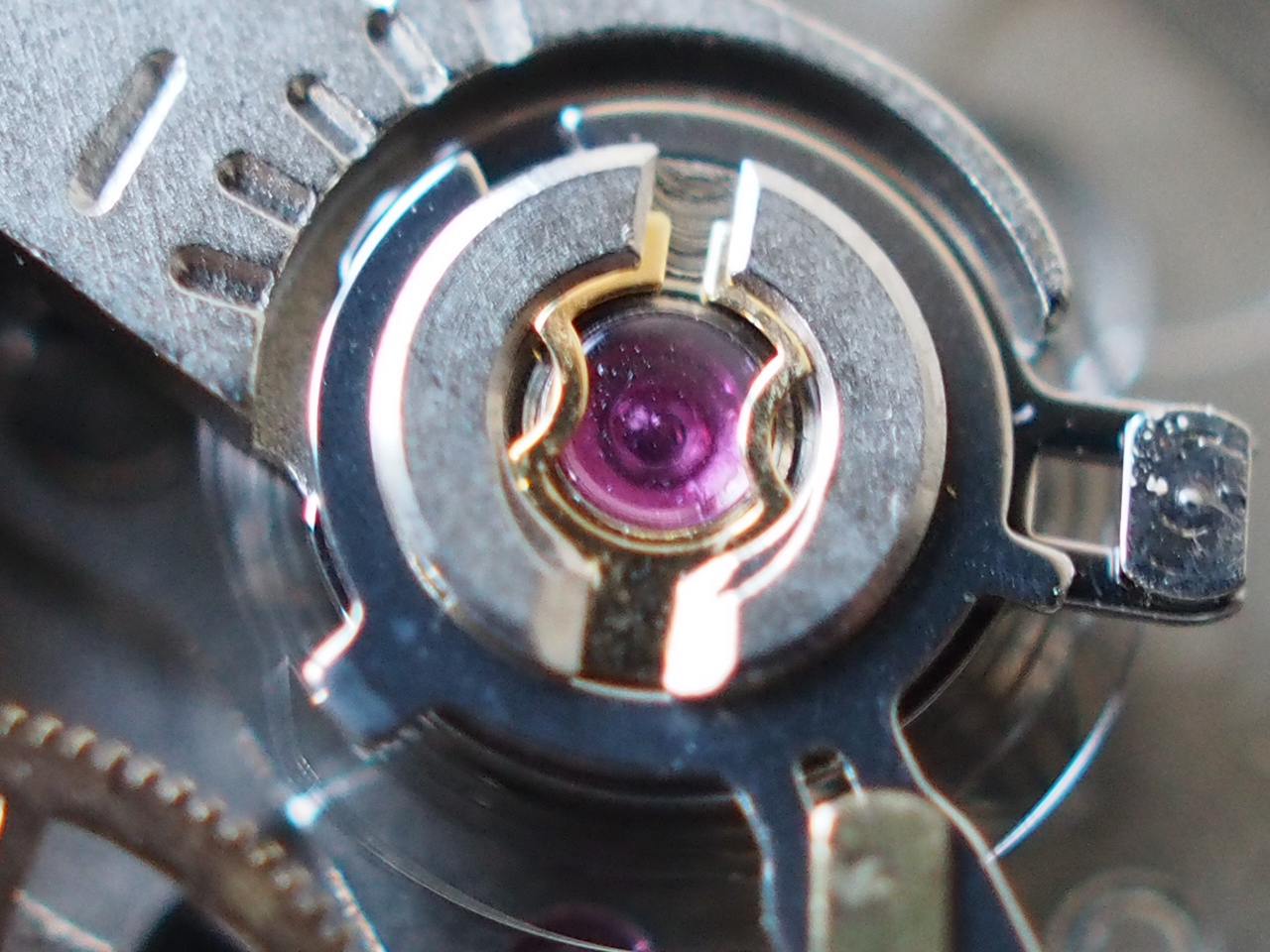

This has been discussed already but I will restrict it to a simple question. Any real chances of bringing it in place with upsetting the block?
I was thinking of keeping the spring vertical with rodico and place it diagonally in the opening.
Not fun and not easy considering  the need to do this within a clear bag.

This happens sometimes. You need to reinsert diagonally one leg at a time very carefully. Under magnification works best. I would personally do this with fine tweezers, not actually holding the spring, but working the ends in carefully as it rests on the Incabloc.

Forgot to mention that there is a very high probability that the clip will fling out a couple of times.

That is where the clear bag comes into play.

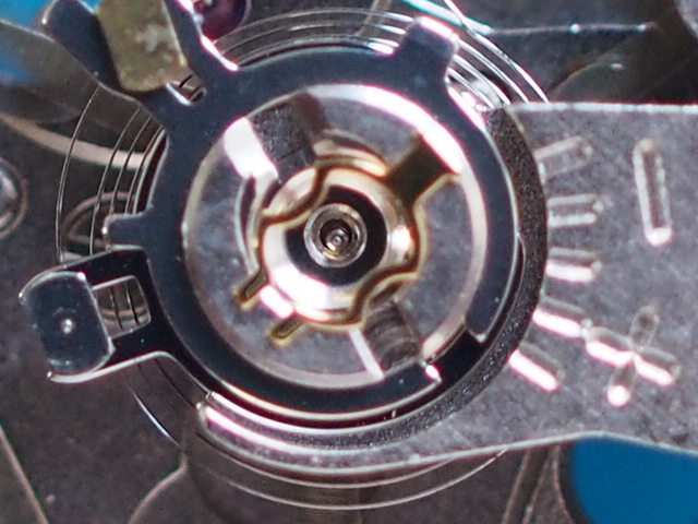

Funny I just did one of these they can be a pain. Was I did was to hold the the spring vertical with my  tweezers  with the tabs in line with the grove then I turn my movement holder a 1/4 turn and it felt right in. You have to remember they enough room to do this since the spring with hing up for service. I did do this work under my microscope.
OK, it went in. First i cut an hole in adhesive tape which I placed to cover That is essential unless you like the spring to enter the movement at some point. The spring wouldn't go all the way down vertically, the chamfers made it jump all over the place. Looking carefully I saw some space on both sides of the cut, just above the regulator ring, so I placed the spring horizonally with the smallest moves pushed it toward the center. Next drama was removing the tape without touching the spring. Oh well.

Genuine ETA in an Oris. Google for Incabloc images to see what great variety of shapes the block can have. From that I suppose that some are more prone to the problem. And the microscopical hinges may not be 100% perfect.
