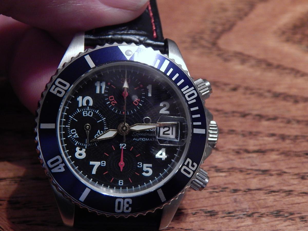

    Tonight I find myself in a state of puzzlement and am asking for a little help and advice. Recently I have found that I really enjoy working on the 7750 movement. After rebuilding 3-4 I find that I have managed to accumulate a small collection of spare parts. Last week I decided to buy a few more and build another. For general information this particular movement is marked Val 7750 rather than eta 7750. I've got it running well but do have an issue with the hour counting wheel. For some reason it wants to run all the time. I have replaced that wheel with a new one and even replaced the hour counter lock but neither helped. When I activated the chronograph and then reset it the hour counter will reset to proper position but will just keep on running from there. I have also got a new hour hammer spring installed as that was one of the parts I needed anyway. Any ideas would be appreciated.

Hi Charles, I've just been having a good look at the 7750 hour wheel assembly and it looks like it has a slipping clutch built in it to transmit drive to the hour hand.
If that clutch is too tight, the hour wheel brake may not be strong enough to resist this drive force to prevent it from rotating. I would assume that this clutch should be lubricated in such a way that it slips very easily when the brake is applied.
Is the lower pivot hole for the hour wheel worn?
These are just ideas, as like Clockboy I haven't worked on one.

   So far I have left the watch alone for a day or so. Repaired a Tag for someone at local jewelry store and have been thinking about valjoux. Once you put calendar bridge on you can't see the action of the hour wheel. What I've done is to try to visualize how things went together as I was assembling. I remembered the hour wheel may have been sitting too high on the main plate. I think it is so high that the lock may not actually hit wheel. Tomorrow I'll take it apart and check on this theory. I kind of thought about this after reading Geo's post when he mentioned the lower pivot hole. After I check that I'll let you know what I find. What I'll do this time though is put calendar bridge on and then put a hand on hour wheel and check out watch before installing dial and all the hands.

   Well I had to work today however when I got home my wife was out shopping so it was a perfect time to check out the valjoux. When I took it apart the hour counting wheel moved some. I repositioned everything and looked at lock and wheel and it did appear as if wheel was too high, possibly not going not going all the way into the lower pivot hole. I had an old hour counting wheel and tried that to see how it fit. Looked like a perfect fit. Now I'm scratching my head wondering why the new part didn't fit properly. I put the old counting wheel in and put everything back together. That was about three hours ago and so far everything is perfect. Now all I have to do is wait for the oscillating weight I ordered to arrive.   Thank you Geo for saying something about that pivot hole. As soon as I read that I started remembering the wheel wanted to lean a bit when in place but to make contact with the lock it has to sit very close to the plate and doesn't have room to lean much.

Is it running constantly as soon as the chronograph starts and is then paused? If so, the plastic, L shaped clutch is worn. You can make it wider with a staking set (just gently hit the edge that engages the wheel). I had that issue with my speedmaster auto, and that's how the watchmaker fixed it.
Hi,
   Yes the hand was running all the time but when I was putting the watch together I had to buy a new hour lock as I didn't have the old one. Changing out the hour wheel fixed mine. The hour wheel I was trying to use would not fit properly into the lower pivot hole which meant the lock was sitting lower than the wheel and would not make contact when chronograph function was not in use. Anyway I've got it running well now but I do appreciate the tip.

   Sometimes you think you have solved an issue only to be tricked. After I changed out the hour counting wheel my watch ran well for several days and then for seemingly no reason the hour counting hand took off running again. When I took the watch out of the case to check it out again I looked at the movement from the side before doing anything and noticed that the hammer spring had worked its way slightly under hour hammer operating lever. That meant there wasn't enough pressure on the spring to hold the lock up tight against the hour counting wheel. The operating lever was actually off its pivot as was the hour hammer. Saw that when I removed the calendar platform. I started thinking that there must surely be some way to hold these parts down and I checked out another calendar platform I had. This other platform was milled in such a way as to prevent the operating lever from raising up and now to problem is really solved. I'll post some pictures later as this was something very strange.

   Well so much for the picture of the strange gap. I put the old platform on another mainplate and it fit perfectly with no gap. I'm not sure what went on originally but I couldn't take out the gap until I changed out the calendar platform. Anyway there's no gap now and watch is running perfectly. I did promise a picture though so here is what the finished watch that I put together out of bits and pieces looks like now. I did buy the dial and case but I wanted it to look nice.
Charles K
