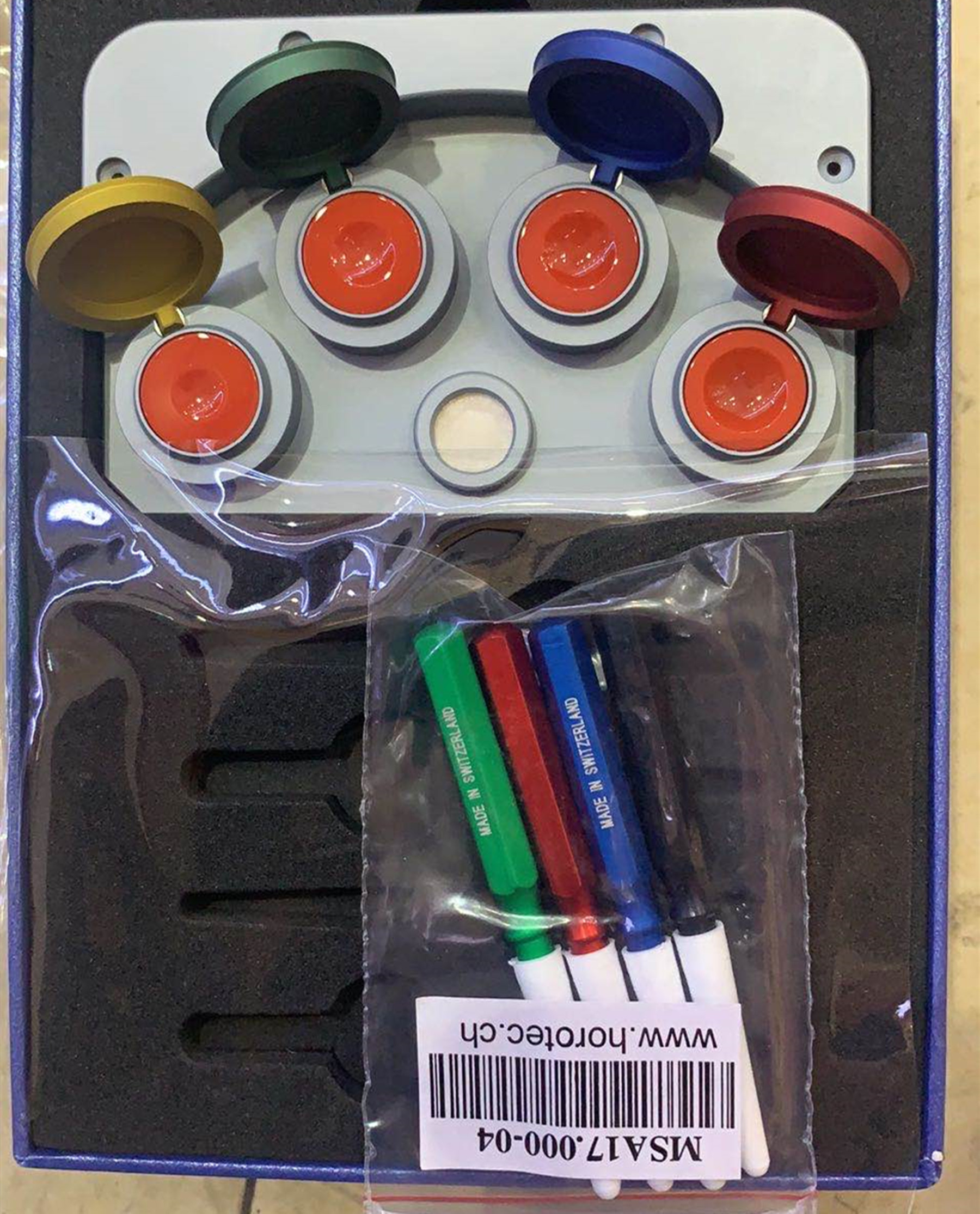

Thanks for your stuff! Maybe your Switzerland oiler is Horotec or AF.
The 7013 have pipe niddle shape like as little bit modified syringe's. And 5423 and 30102 have same flat tip like spoon. If so, can I understand 7013 give more accuracy quantity of oil by its shape?

No, I started with normal oilers. This A*F set show in the picture here (no longer for sale it seems).
19 hours ago, HonestRepair said:
Can you share your expirence more detail?
I found it extremely difficult to oil jewel holes with any precision, not to mention pallet stones, using ordinary oilers and an eye glass. So, I got myself the Bergeon ergonomic oiler set, an inexpensive Chinese stereo microscope, and after that oiling jewels holes and pallet stones has been become a lot easier and very precise. Quite an investment at the time not knowing if my interest would take off, but it did and I now consider these tools some of my most important alongside good tweezers and screwdrivers.
