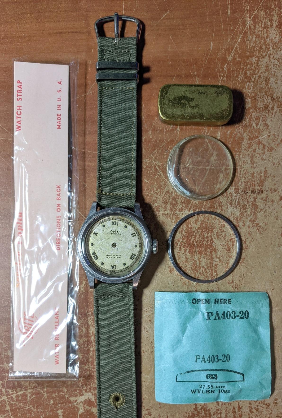

Mr. Roundel, you have the exact idea. The crystal must fit over the bezel, rather than inside it. I'm fairly comfortable selecting the correct size high dome acrylic, but these PA waterproof type crystals are another matter entirely. To clarify, this type of crystal can be pressed on by hand and doesn't require a crystal lift. It's not a PHD or Stella High Dome type.
For example, I have a Wyler with a bumper automatic movement. I can't find the model name, so I went by the original crystal size: 27.2mm outer diameter. The GS catalog had one for a Wyler "1073" that was 27.2mm, model PA385-25, so I ordered one (at a cost of around $15.00). When it arrived, it measured 27.0mm actual outer diameter, thus too small. So, I moved on to the next Wyler crystal that was nearest in size, a 27.55mm for a Wyler "1085", model PA403-20. This crystal actually fit over the bezel, BUT the outer ring will not fit over the outside of the new crystal! I'd also ordered yet another crystal for a different Wyler (it too was the wrong size, of course), so by then I was out nearly $50.00 with only one (barely) fitted crystal. That's when I thought it best to ask here before I have more crystals than Waterford.
The Wyler in question:

Oh, and on the GP case, it is the bezel, incorporated with the lugs, that must fit over the crystal. So while there are similarities in design between the GP and Wyler waterproof cases of the period, there are also important differences. I just tried a GS PA 360 25.9mm that was marked for a "Harvel" watch. It fits PERFECTLY over the case back. Unfortunately, it seems to be ever-so-slightly too thin to hold let the bezel hold well to the lower assembly (Case back and crystal.). I think I am going to end up shimming it somehow, or even placing a few spots of glue somewhere at the join between the crystal and bezel.
