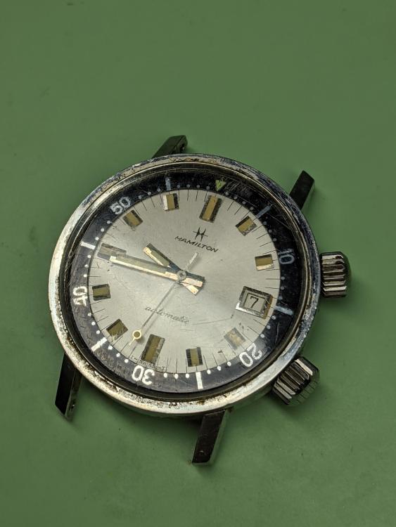

I have a Hamilton 600 with a stuck caseback. Any advice on how to loosen it without damaging the lugs, or caseback itself?
It desperately needs a service, and an ultrasonic bath as you can see.
Thank you!
Thank you!
    notice the flats.  a large cresent wrench can turn this.   you need a "fixture" to hold the case securley.  i use the wooden block.  this case has fine threads and might be "cross threaded".  be careful,  good luck.  vin

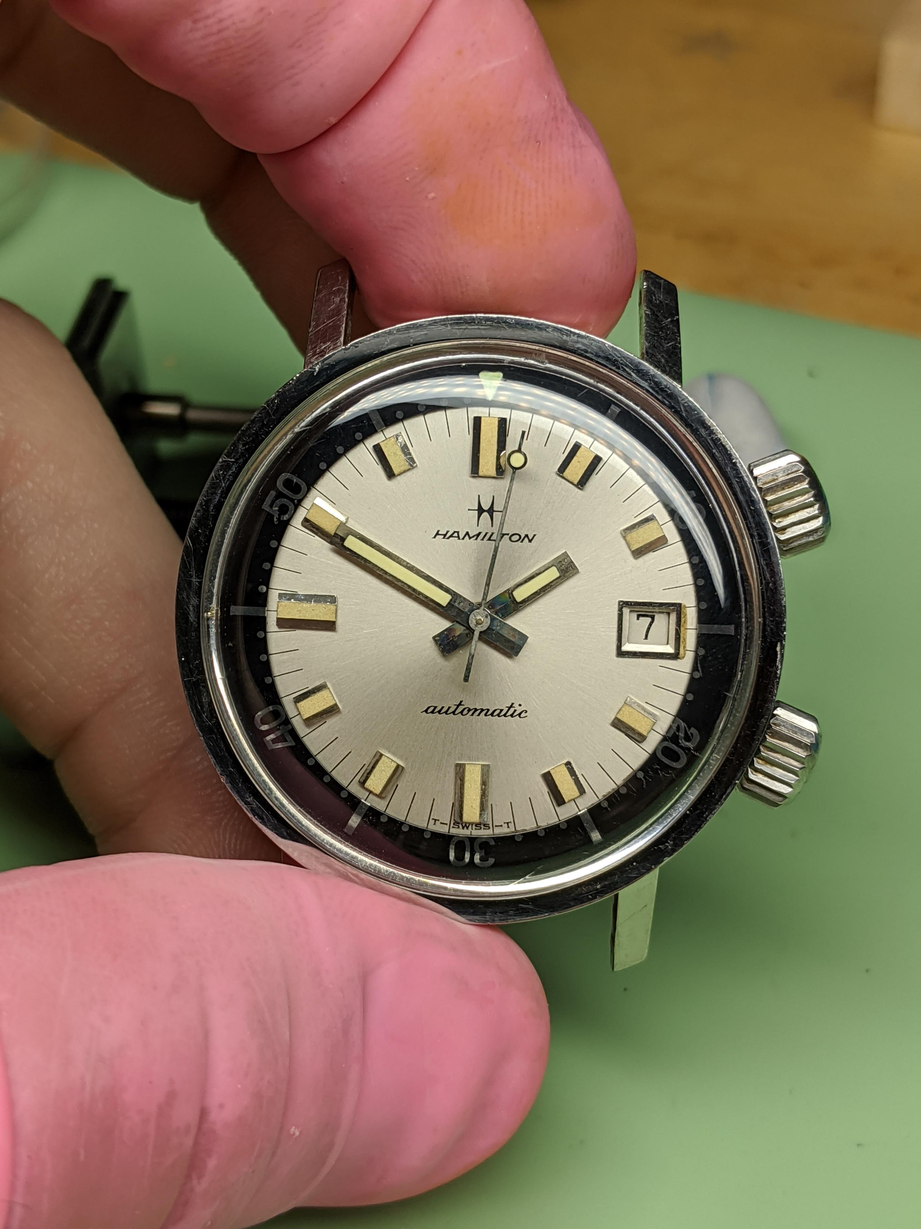

Update: I was able to get it off with the nut and glue trick. I also heated it slightly with a blowdryer. The gasket had basically turned to glue in the back. In the midst of service as we speak!
