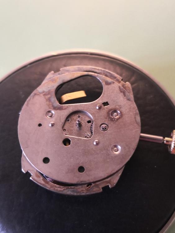

OK I have an m62 movement and it's not running but the one in the picture is, but not sure what movement but it's from a no day date dial. So can I swap day date dial plate over? If so how do you stop Bridge popping off when you remove the 3 screws? Is it just a case of be careful or is there a better way?
the day date is a model 262 and the other movement looks to be a 40.  I don't know all the interchangeable parts with the electric models. What I do know is although the parts may seem alike they may not be.  I comes to mind that there is a notation in one of the service manuals that the internal wheels are not compatible between models.  Which that is I don't remember, so advise that what you are attempting is not likely to work.
