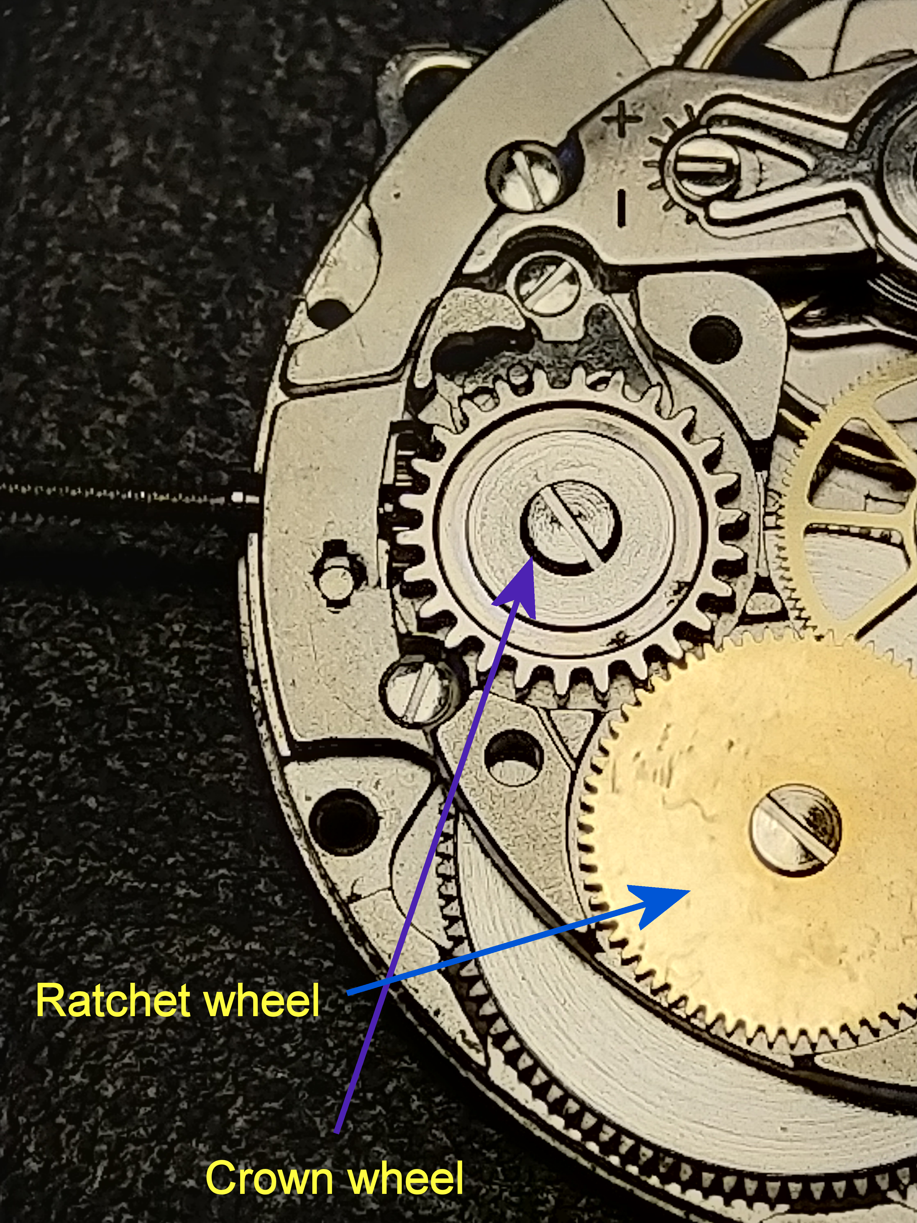

Hi winding via the rotor weight and the stem are independent, The former working through a set of reduction gears mounted seperatly on the movment. This can usually removed as a unit being unscrewed from the plate. The latter utilises a train of gears a d a silding clutch on the stem, both operate on the ratchet wheel and wind the watch.  As the watch winds ok on the rotor the ratchet wheel and barrel must be ok, Therfore the next logical step is to remove the reduction gear plate to gain access to the barrel and the gear that you have outlined, probably find a broken tooth or a dry jammed gear( indicated).
Just a thought..
Both the automatic and the manual winding use the same ratchet wheel and crown wheel otherwise the mainspring would unwind.
So to be clear .. the gear you refer too is the crown wheel?
When winding with the stem it is directly driven by the winding pinion.
The mainspring is wound by the crownwheel transfering the motion to the ratchet wheel.
The ratchet wheel is directly connected to the barrel arbour.
To prevent the mainspring to unwind itself the crown wheel is equipped with a click. it has a small nobb that goes in to the gears in the
crown wheel and locks it from running in more than one direction. The tension to the click is generated bu the clickspring.
When removing the nut on the crown wheel one have to remeber it is a left threaded one.
So when fault finding the winding one should keep this concept in mind.
If the watch is winding when the rotor is running then the whole chain just described must be ok.
On the other hand one must be sure it actually winds it.
I would check if it winds it with the rotor and if it do the fault must be in the god old keyless..Keyless.thumb.png.c62a98d7f9771afa887cb03d3c031b5f.png

I think I can see what I have done wrong. I’ll strip the keyless and start again!

Woohooo fixed and it winds. Thanks all.
