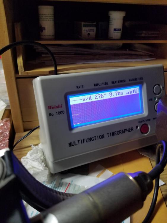

Took a new video with a partial assembly. Rotation appears approx 3/4 .Also pic of timing.  Not reading very well as you can see

Your TG trace really is quite something, sadly there is nothing readable in it at all. This could be down to many things but I would start by checking that the escape wheel teeth and the pallet jewels are spotlessly clean, and that the hair spring isn't touching anything that it shouldn't. Also that the pallet jewels are secure and correctly aligned in the pallet. Once the trace cleans up a bit then you can get some useful information from it.
Just from scrolling through both videos, one frame at a time, it looks as if you're getting around 340 degrees of amplitude, which seems excessive. My best guess is that you're getting too much power from the mainspring.

It looks to me more like a total rotational angle of 340 degrees from extreme clockwise point to extreme anti-clockwise point, which equates to an amplitude of only 170 degrees.
Until you get the amplitude up to 220 or higher the TG trace will be of little use, and ideally you want to see the amplitude up above 265 to 270 degrees (total rotation of 530 degrees or higher) after a full service and with a new m/s.

Changed balance and hairspring. Removed pallet ok. New video. Rotation almost 540(270 ampl). Getting there
unless the hairspring stud is on an adjustable arm, you'll have to move the hairspring collet to tighten up that beat error. That will likely also improve your amplitude. Excellent progress!:thumbsu:
