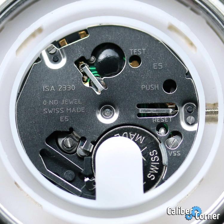

Background: I know absolutely nothing about how to fix watches. I purchased this Hanowa Swiss Military movement ISA 2330 for $32 on ebay in 2016. I forgot I had it until my other daily watch broke (also Hanowa). After taking it to a watch repair shop to get the battery replaced, we discovered that the second-hand kept sticking. The watch store clerk thought it was the battery, but even after replacing a new one the second hand continued to stick. He recommended doing a "total overhaul". Because I didn't pay very much, I figured it would be a good first project to fix on my own. At first I thought about taking it apart to fix it but trashed that idea when discovering the movement itself is only $16! I guess I expected the movement to be more pricey since a new watch replacement is close to $200. Apologies in advance for those who will shriek at my questions.
So here is what I would like to accomplish:
- A solution that is easy, long-lasting and easy to maintain. Basically, what would I have to do to keep this watch running for the next 30 years.
- Preferably budgeted under $75
Thoughts and questions:
1) Are there "better" movements that I should consider using that will fit this watch?
2) Since I want long-term function, would it be better to make this an automatic movement?
3) How long would a replacement ISA 2330 movement last and is it my best option to keep the watch original?
https://www.esslinger.com/isa-watch-movement-isa2330-103-quartz-movements/
New movement $15.95....quartz is not the easiest to work on esp if you don’t know what you are doing tools used on quartz movements are also very specific. So i suggest just a quick and easy movement swap. It’s the most basic thing you can learn if you are new to the hobby. Learn to remove stem, dial, and hands. Then re-assemble. You will need watchmaker non-magnetic screwdrivers/tweezers, hand puller, and hand setter.

ahhh weasol I almost forgot case back opener duhhh, and def eye loop. Only thing i would say different is tweezer number 3 or even number 2 something with wider and tapered shanks. #5 is way too thin and mostly reserved for very fine detailed work. Someone experienced prob could use it for mostly anything but to a beginner it could mean many screws and parts flying across the room. OP just make sure they are non magnetic, because anything that becomes magnetized could potentially do harm to a quartz movement even more so than a mechanical.
Thank you both for you advice and information! I purchased the following items from esslinger today and they should be arriving next week. I am looking forward to working on this small project and having the watch back to working order. I already had the tool to take the back off and a pair of cheap tweezers that came with the amazon set purchased earlier. The one thing I didn't include was cleaning supplies because I didn't know if they were necessary for just replacing the movement. I chose to get the finger cots as a second option.
