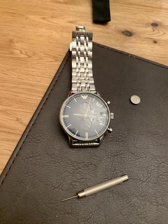

I have an armani fashion watch and have came across an issue.
The movement is seperate from the watch face, the face seems to be part of the watch case.
No obvious bezel on the watch so unsure on how to remove the crystal to re attach the hands.
I have seen a video on YouTube, which lead me here, using air to pop out the crystal. I was wondering if anyone else has experience with the type of design and if the air method you likely be the best way forward?
One of the options would be a hair dryer to try and warm it and see if it releases glue.
Otherwise the air method might be practical as you cant get the dial out without taking the glass out.
What was your reason behind removing the glass?
Screw the back back on, attach a piece of tubing that will fit on to the stem tube, on to a suitable large syringe, or even a balloon or bicycle pump.
Attach that to the stem tube. Fire air in through the stem tube, and see if the glass pops out.
This will obviously only work if the pressure can build up, so if the air leaks out of the pushers, or the case back then it wont work, in which case, you might have to be creative with some reversible sealing method, hot melt glue maybe, but be careful you don't gunk things up or  cause any irreversible damage.

I will try the air method and some heat tonight.
The pinion on the movement passes through the dial, which cannot be removed from the back of the watch.
To reattach the hands I am assuming that the movement will have to be positioned and the hands then attached from the front of the watch, requiring the crystal to be removed.

The crystal is domed glass, apparently sapphire.
There also seems to be no bezel on the watch, the case is one piece with no distinguishable seem where a bezel will attach.
I suspect that the crystal is press fit into the case.
That's not good. I would be very cautious of any approach that would cause the  crystal to flex. Sapphire glass doesn't take kindly to bending.
Well guys, I took the risk with the air technique, but also bore in mind Marc's guidance, so made sure I was as delicate as possible...
Crystal came out with no damage and I was able to fully reassemble the watch.
Thank you to everyone that took the time to give advice, very much appreciated.
One last thing, on the watch the second hand is the lower sub-dial, the large second hand is a chronograph.
This watch was repaired a number of years ago and when it was returned the chronograph hand was at the 3rd increment, instead of at 12.
When I reassembled the watch today I took care to place all hands pointing towards 12. I started the chronograph and it jumped back to the 3rd increment and stopped moving. Starting it again it  works as normal, but again from the 3rd increment. Reseting the chronograph the hand returns back to the third increment, like in the attached photo.
Any idea what may be causing this?

Hi Josue,
Yeah, was pretty simple. Pulling the crow to the time set position and then holding the pushers allowed the chrono hand to be reset.
See the below youtube link for instuctions:
PS. thankyou to everyone that assisted with this repair, watch is now in full working order.
