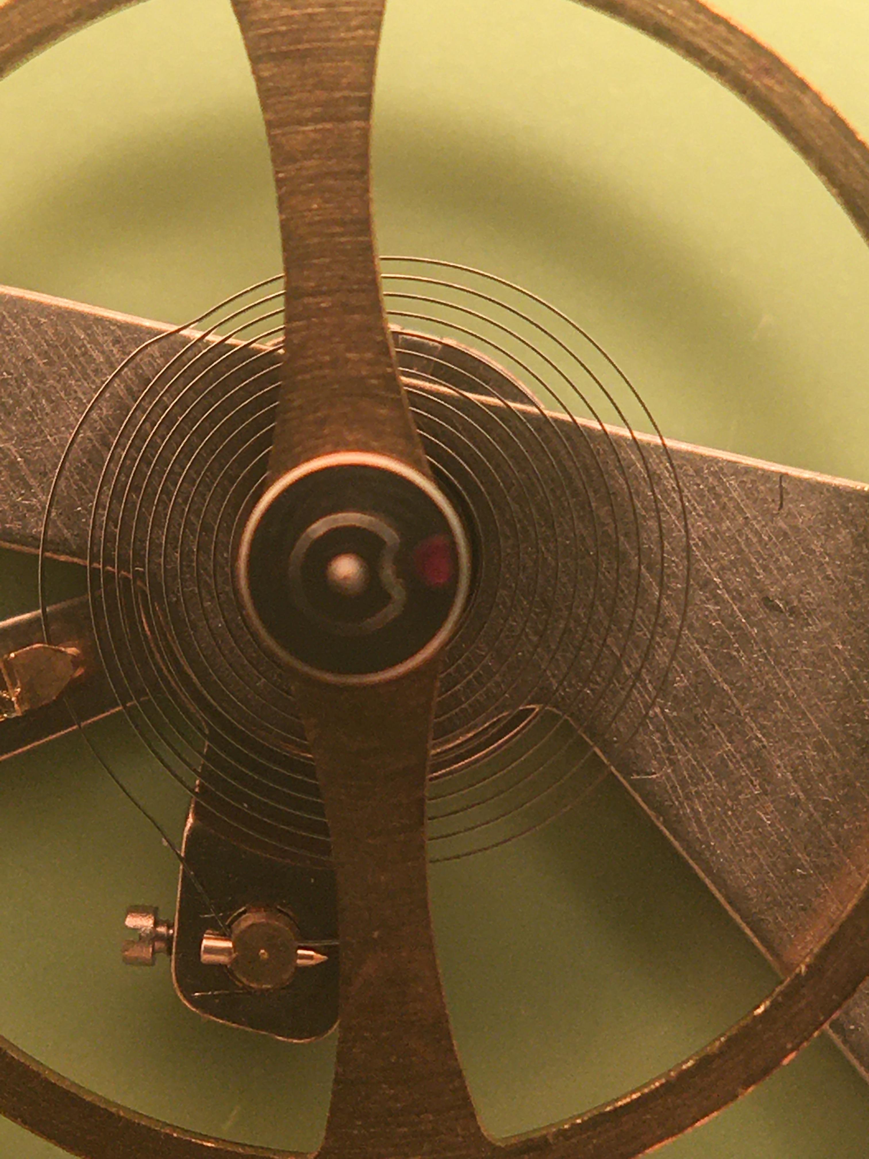

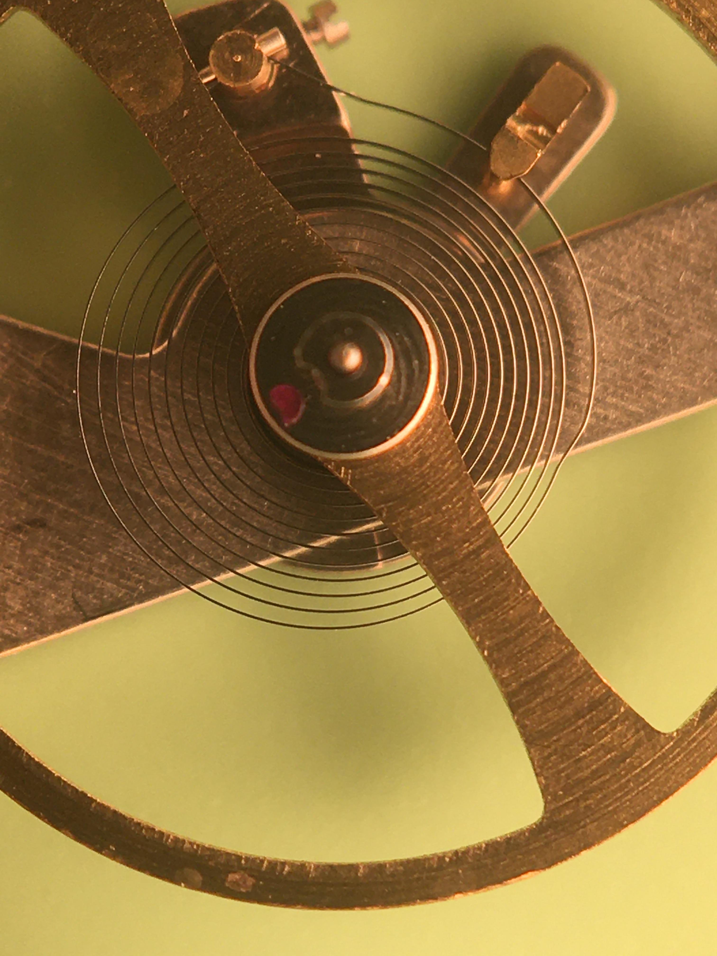

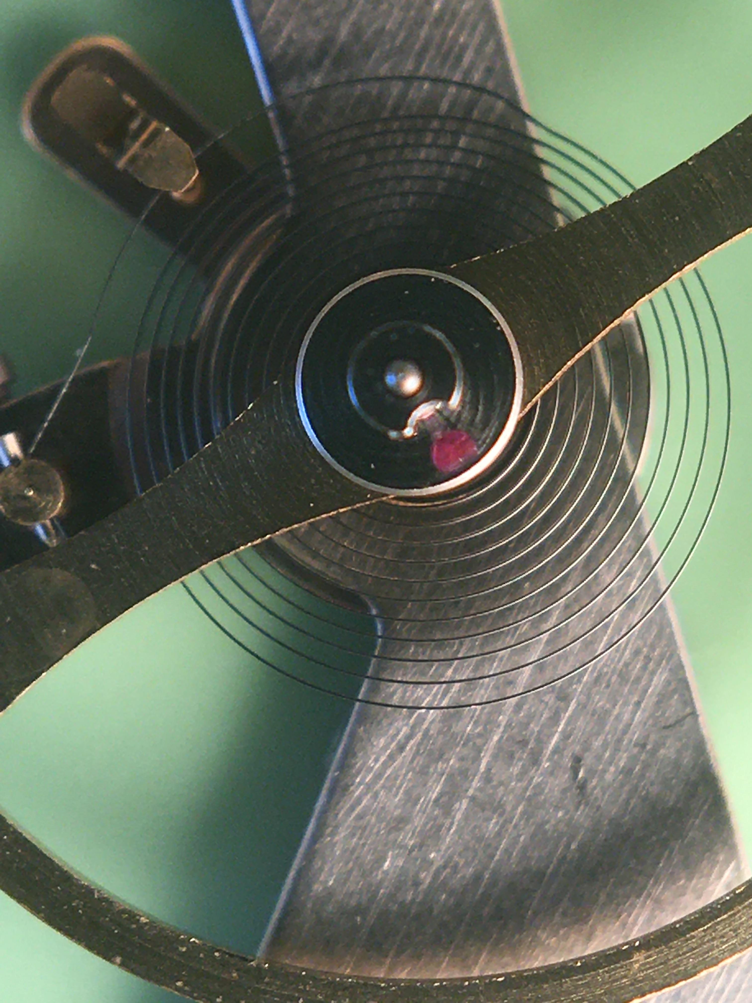

I'm a beginner.  Below are some pics of an Orient H9 hairspring.  It appears lopsided to me but I'm not sure.  The amplitude is about 180.

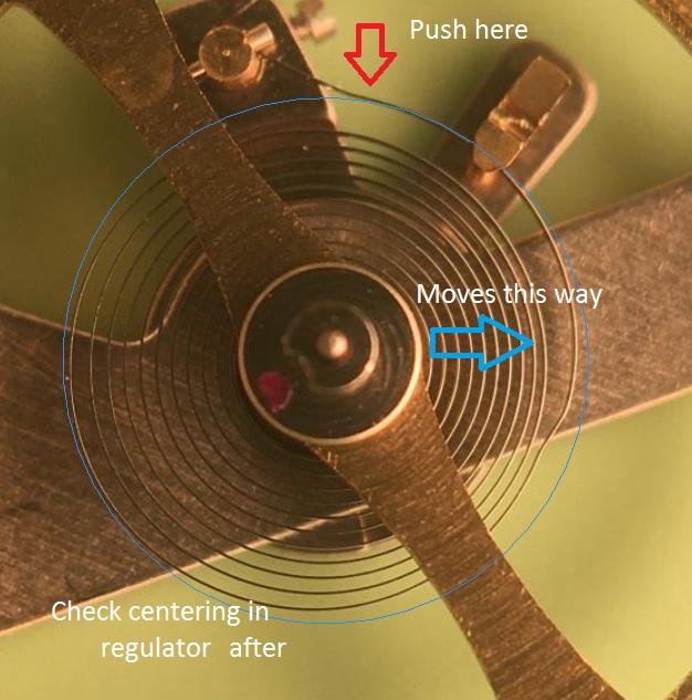

It's out of center, check pic for adjustment. The spring should be centered in the regulator when you're done, if it's not, push it right next to the stud to make it centered. The pins (pin and boot) should have a gap of about 1 hairspring thickness, and it should bounce from one to the other evenly when running.

Look at the spring position BETWEEN the regulator pins.  If its central to both pins, I vote to leave it alone.  The old guys (Fried and De Carle) often suggested using a slight bend in the hairspring  to centralize the spring position between regulator pins.  It does appear to be a little eccentric.
At any rate, I doubt your slight kink would be a reason for low amplitude.

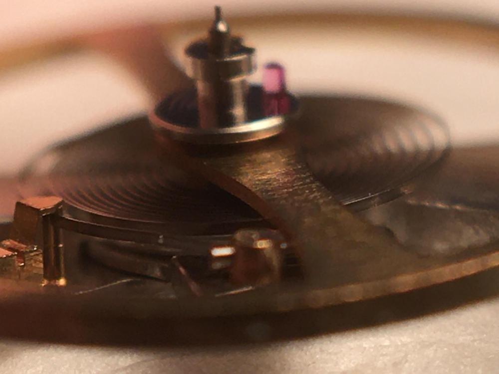

Is it level ?        If level, all you need done is to push on the HS where Nickelsilver drew arrow, which is to be done when installed.

We need a clear picture looking in sideways at the hairspring and balance wheel in the watch.
Then yes technically her out a center but it's minimal it shouldn't be the cause of amplitude problems. They hairspring not flat would be a cause of problems especially when it's touching something.

It's hard to get a focused side shot.  It looks level to me.  Though, the focusing may make it appear otherwise.

IMG_3945.thumb.JPG.a04788d3f873214ee43cfa296f9e7085.JPGd side shot, below.  Looks flat to me.
It looks pretty good to me (Said the idiot that totally trashed a hairspring doing a VERY SIMPLE JOB yesterday).
My suggestion would be to look elsewhere for the low amplitude issues BEFORE you even consider touching the HS.    Mainspring, train freedom, dirt, pivots, etc.  HS work is difficult at best.
