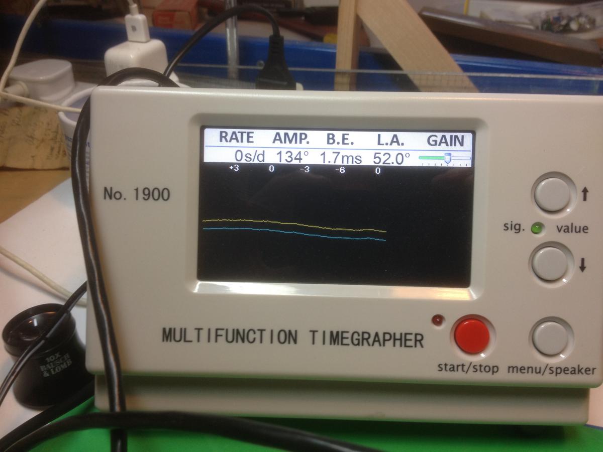

I have been working on a Seiko auto and when stripped down I noticed that the inside of the lid of the barrel was badley scored and it looked like the spring have been dragging on the scores. Normally a new barrel & spring would be the answer but the barrel is now an obsolete item. So as a fix I attached it to a stepped chuck on my lathe and skimmed a small amount away and polished the score away. My question is this an acceptable practice because this was the only way around I could think of. I reassembled and all seems to working fine so I guess I did right

Thanks WRT the watch is running fine looking at it now as I type so I think the skim has worked. Geo is getting the wrong idea I think of what I did. I skimmed & polished the inside of not the barrel wall or any thing on the main barrel that holds the spring just the top which fits on with a lip effect the same as the 7009a. I always thought there was a small gap between the lid of a mainspring barrel and the spring but this looks as though it had been rubbing on the lid hence the scoring.
However this watch is also not of any real importance so I can if time strip again and show my repair but of course I cannot show how it was before.
In the clock world cleaning up barrels with lathes is common but of cause the tolerances are not as critical as a watch

I am pretty sure you have removed a couple of microns of material and I am sure it will not make much difference to the running of the watch and would actually be more benefit then impedance. Some purists will turn their noses up at what you did, but I am not one of them. I commend you for your innovation.

For those who followed this post I skimmed a macro amount of steel of the inside of the lid of the barrel because of damage & a replacement was not available.
Well it has been on my wrist for the last two days and it has lost 1 minute so initially I would say the work around has worked BUT….
When on the timing machine see pic all looks good until moved to another position and there is a flurry of snow for a while before it settles down again. I don,t if is the low amplitude, a mainspring issue or something else in the watch not being correct. This is where the more experienced watch repairers knowledge comes in to play.
However because of the above I will just keep this one in my Seiko spares box. I thought it was a well worth experiment anyway.
