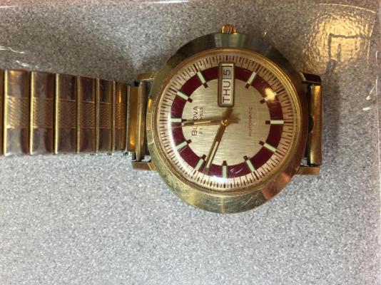

I was working on a lovely Bulova auto this past weekend. The original complaint was that the crown was VERY stiff - difficult to turn for winding/setting, and difficult to pull out into the setting/date change positions. A cursory inspection revealed that the watch was well overdue for service, so I opted for a full disassembly, cleaning, and re-oiling. This would give me an opportunity to closely inspect the train and the keyless work, where I felt the problem was most likely to originate.
No unexpected problems were found, and the service went well. Upon completion, the watch was running beautifully, winding and setting were smooth and silky.

I let the watch run for 24+, as I like to do before casing. It went well, so I was keen to close everything up and pat myself firmly on the back. When the time came to re-install the stem, I learned that the problem had not, in fact, been completely eliminated. The final few mm of push to seat the crown had a fair bit of resistance. First thoughts were bent stem, interference with the tube, something along those lines. I removed the movement and confirmed that everything operated correctly out of the case. Inspection of the stem and tube revealed no anomalies or misalignments. I then installed the stem into the empty case, and discovered that whatever the problem, it was the relationship between these two parts that was at it's root.
That point marked the end of watch time for the day, and I had to walk away in favour of other pursuits.
Today, during the course of my daily routine, my mind seems to have this task running in the background, and it is using its spare cycles to work this seemingly simple problem. There must be some dirt/gunk/old stem gasket inside of the crown that is interfering with the tube when it is inserted. I'll investigate this evening.
I'm not sure this is even a post-worthy issue. Not particularly interesting or difficult. I think I just needed to put it down to settle my wandering mind. Having said that, even the simplest problem can sometimes be caused by strange or unusual phenomenon which are only visible to the experienced eye. With that in mind, perhaps some sage advice may emerge from one possessing greater wisdom than I.
I'll post back after I remove, inspect, and clean the crown cavity.  I know you will all be on the edges of your collective seats until then.

BTW, the case and crystal both polished up nicely:
post-456-0-73973500-1419294055_thumb.jpe
The problem was the crown o-ring.
It wasn't even damaged, just neglected.
This 40(ish)yo watch has definitely missed a service interval or two. As a result, the crown gasket had probably never been lubed. Now, I know full well the value of adequate lube, but I did not expect the near seizure of the crown the way this was. A tiny smidge of silicone, and hey presto! Works like day one. I replaced it all the same.
It regulated superbly, and will serve well for another decade or so.
THE MORAL OF THE STORY:
Watches are complicated and precise bits of machinery. The faults which cripple them are (usually) not. As in most troubleshooting process, always focus on the simplest causes first, instead of assuming that the problem is as convoluted as your imagination is trying to make it out to be.
-Jeremy
