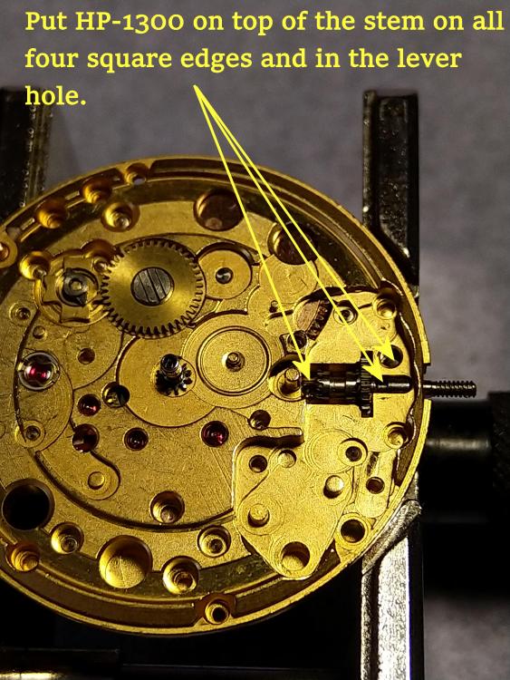

So hey ho here we go!
This version of movement has a quick date set on which you push the crown to set the date otherwise its quite straight forward.
I start from a almost stripped subject.
The first thing we do is to lubricate the sliding pinion with HP-1300, I aply two smal dots on each side of the gears and one small dot in the sliding pinipn grove.
The winding pinion gets two small dots of 9504 grease on the teeth and a small dot on the smooth side of the winding pinion.
I drop the sliding and winding pinion into place. I lubricate the stem with HP-1300 microscopic dots on the top the square sides where the sliding pinion sits and in the groove which keeps the stem in place.
I put a small amount in the whole where the stem release nob is going.
In goes the setting lever. Put a dot HP-1300 on top of the nobb on top of the lever.
In goes the lever spring. put a dot HP-1300 where the lever and spring meets.
Next comes the yoke and a drop of HP-1300 lands ontop of that too.
The yokespring is sometimes tricky but use a peg wood to hold it into place. A drop of HP-1300 goes between the spring and yoke.
The setting lever jumper comes on and incase you forgot to put a dot on the setting lever you can put it in the grove. put a dot on the date quick set lever nob and grove.
And at last the quick set lever goes on and the keyless is finished!
Even if this shows the assebly of the keyless work i will warn about the springiest date spring, it is kept in place behind the bridge and will almost everytime you loosen it try to get airborn.

The trick there is to take the easy way out, one just put the bridge with the spring in it like in the picture, align the bridge and just tighten the screw loosely. Take an oiler and push the sping in behind of the date lever and tighten it up. That's it.
