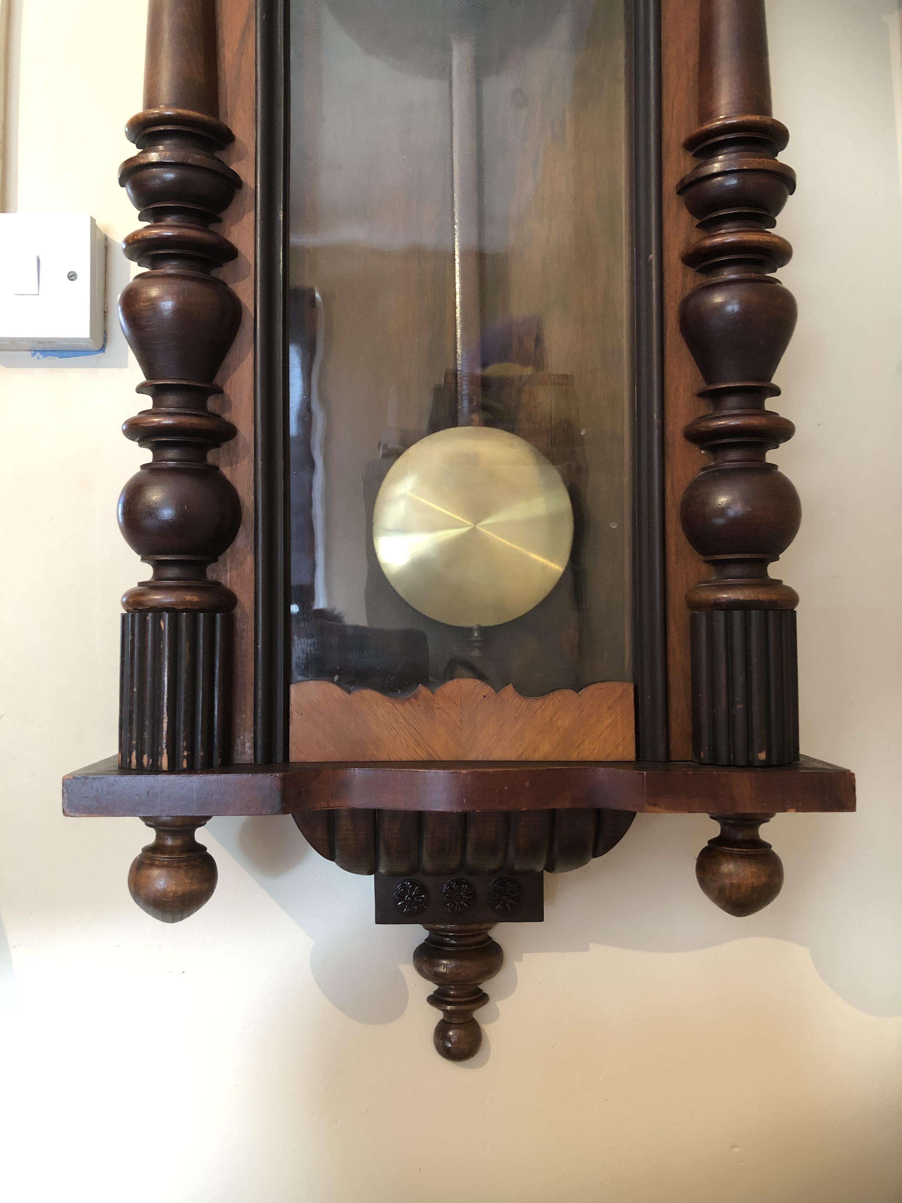

The biggun is a relatively cheap wall clock in the style of a regulator. It needs some casework done. It’s missing the bottom finials ant the bottom center section but it runs well and has kept good time throughout the day, chiming on the hour and half hour. A lovely deep tone.

Just a quick note, the regulator looks to be a Gustav Becker given the closeness of the winding arbours, have a look and see. The French movement, well I would leave this till you have more experience as it is so easy to snap off a pinion and waste a nice movement and case.

The pendulum on the wall clock hangs down from the movement and not from a separate hanger attached to the case which is why I don’t think it’s a regulater. I haven’t taken it out of the case yet to have a look at the movement yet. The prancing horse which sits atop of the top adornments has been broken in the past and has been repaired very poorly. I am aware that these can be replaced so will be looking out for one.

The wall clock is a regulator, the pendulum not being attached to the backboard is of no matter as this went out around the 1870's and millions of regulators were produced with the pendulum attached to the movement. Vienna Regulator is a common name for them, however the vast majority were produced in Germany, Lenzkirch made some outstanding regulators and command high prices. Gustave Becker's are not bad if it is an early one, around the 1900's they lost the solid plates and started with the cut out plates to compete better with the cheaper American ones.
Thanks Jimmy, great info as always. I will do some further research. Pleased to know that it is a regulator. Missing pieces found and ordered so I can make the case complete. Gave it a good clean and polish and it’s now looking quite smart.
Came up nice, the movement comes out easy, just undo the 2 brass ended threaded screws hiden by the dial and it should slip out on the housing bracket rails.
The second photo has a German wall clock, which is a German striking movement, which operates from springs, mistakenly called a Vienna, which it is not. Vienna regulator clocks are weight driven. A timepiece will have a single weight, strike two weights strike, chime three weights.

Big Bertha, up there, is not a "regulator" It is a  wall clock in a "Viennese Regulator"  style. The style of a "gentleman's" regulator. with its strike. :)
Having had a try at removing the movement I’m stumped. The nuts holding in on were easy, unscrew and remove. Nope, it has an arm holding it. Getting to the screw holding that arm to the movement needs black belt yoga levels of  skill! After a tiring day in an office emptying of equipment, people and stuff means I’m tired grumpy and deffo not in the mood to take on the challenge. Plus I cannot be arsed to go down the shed to get the socket set to do it properly :). I’ve got a day off on Wednesday so I’ll try again then.

Squiiffy's clock is communally called a regulator, however in the 'strictest terms' only one of the above weight driven clocks fit this. This would be a, time only, weight driven, seconds beating, deadbeat escapement. About less than 1% of regulators would fit this category, therefore whether it has weights or not the common view is the 'style' is the thing that determines the name not the function.
I’ve spent the day working with wood. Staining, glueing, cutting, screwing, waxing and polishing. Big Bertha is now done and I’ve hung her on the wall in the room that will be my work room.
I’m pleased with the way it’s come out and, even though I am a little biased, I think she looks mighty fine :)
