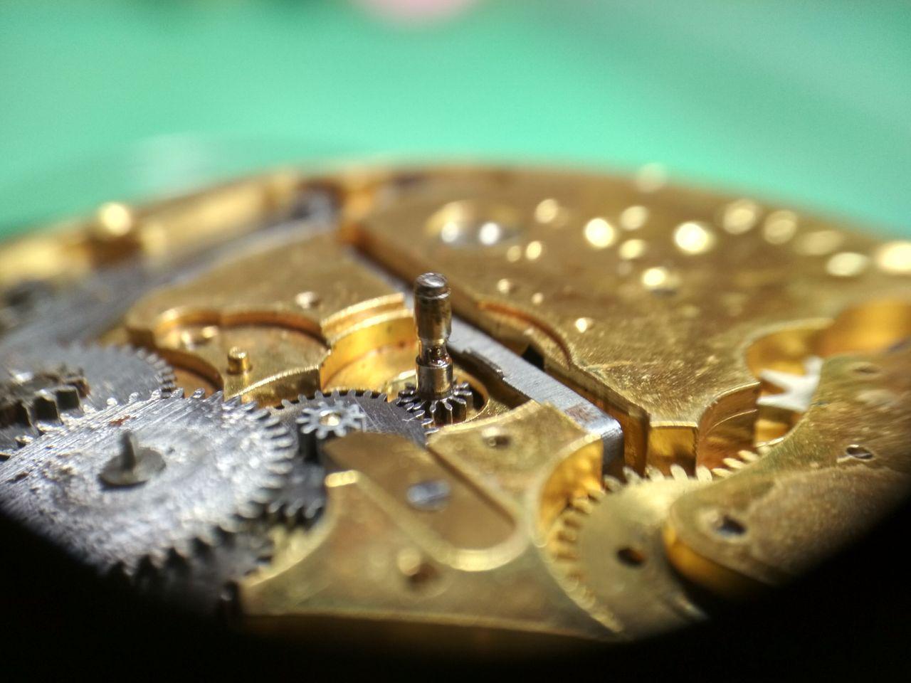

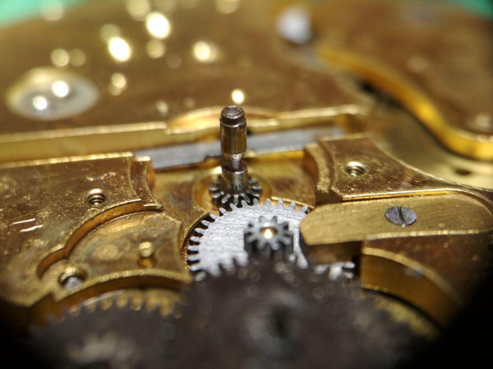

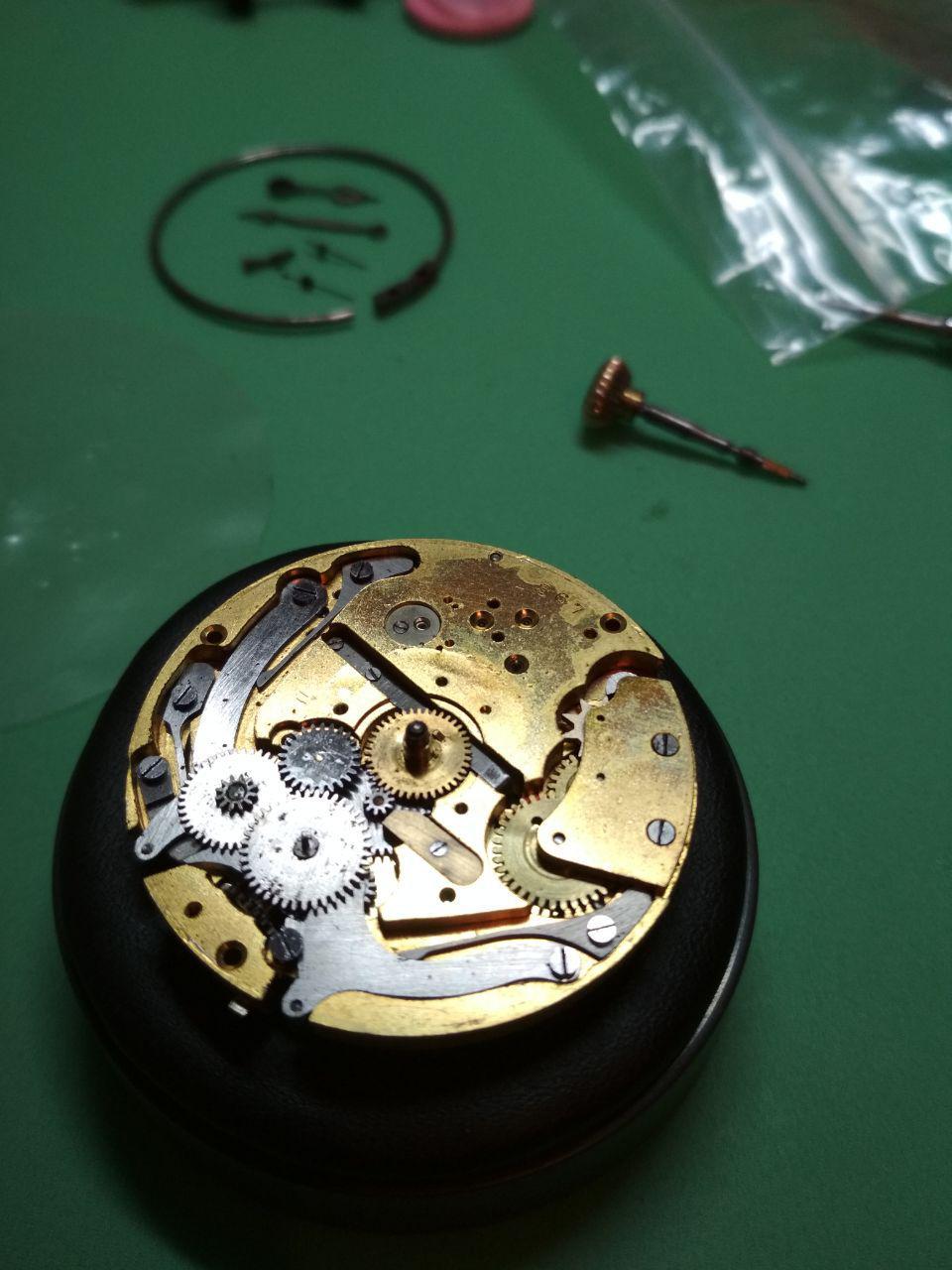

Hi guys,
I was given a Zenith alarm pocket watch to have a look at, the watch runs fine, but when the crown is set to the hand-set position, the hands do not move, only budge slightly, and you can feel quite a bit of resistance.
I removed the movement from the case and inspected the keyless works, I attempted to remove the cannon pinnion and it is quite stuck, I've tried both my presto tool and canon pinion remover, there seems to be no budging it.
On closer inspection you can see some rust at the top of the cannon pinion, and also mid way down the metal seems to have degraded somewhat and more rust is visible.
Is there any chance of getting this removed? I've tried a little bit of oil but it seems to make no difference.
Thanks in advance!

1 minute ago, clockboy said:
The cannon pinion is a unusable cal shape it almost looks to have been squeezed in a lot. Wondering if a previous preparer have tightened it while in situ. Do you know the calibre
I do know from the volume of 3in1 oil that has leaked onto my workbench, that the previous visitor to this movement was fairly clueless.
This is the calibre, http://www.ranfft.de/cgi-bin/bidfun-db.cgi?13&ranfft&207&2uswk&Zenith_19_Reveil
I don't think I will have any luck finding parts for it...
