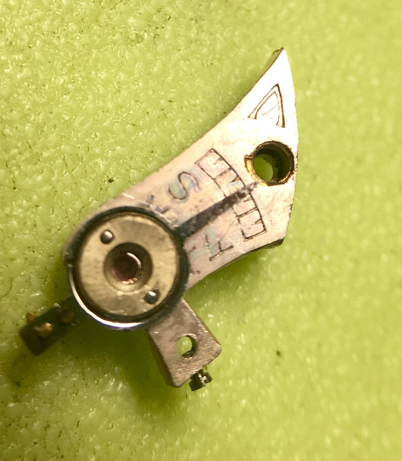

But this headache remains...
I just noted a small imprint on the balance cock (a "V" it looks like) and was wondering if that perhaps rings a bell somewhere...?
A close up photo is attached.
