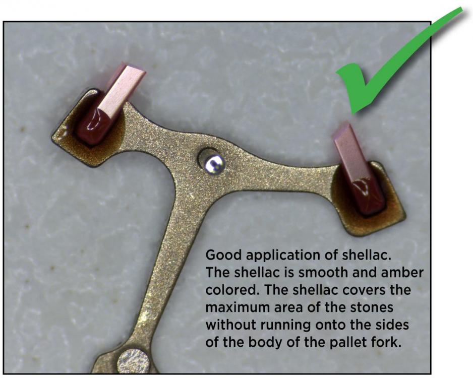

To secure the pallet stones you normally use shellac. Here are photos of how they should and should not look.

Shellac dose not chemically react with metals, which is why watchmakers commonly used shellac, offcourse it is best, if available.
Main disadvantage of shellac is limiting you to only a few types cleaning fluids.
Actually shellac has a much much better property then how it reacts with metals. The pallet stones in the escapement have to be in a very exacting position. They make very expensive tools to make sure that they go in very exacting positions. To use those tools usually requires you to heat up the pallet fork several times and that is the advantage of shellac. When it's heated up it softens you can move the stones around back and forth as much as you want and then each time it hardens back up. Glue only works if you know exactly where those stones have to be.
