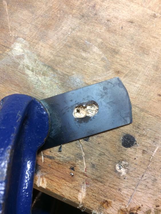

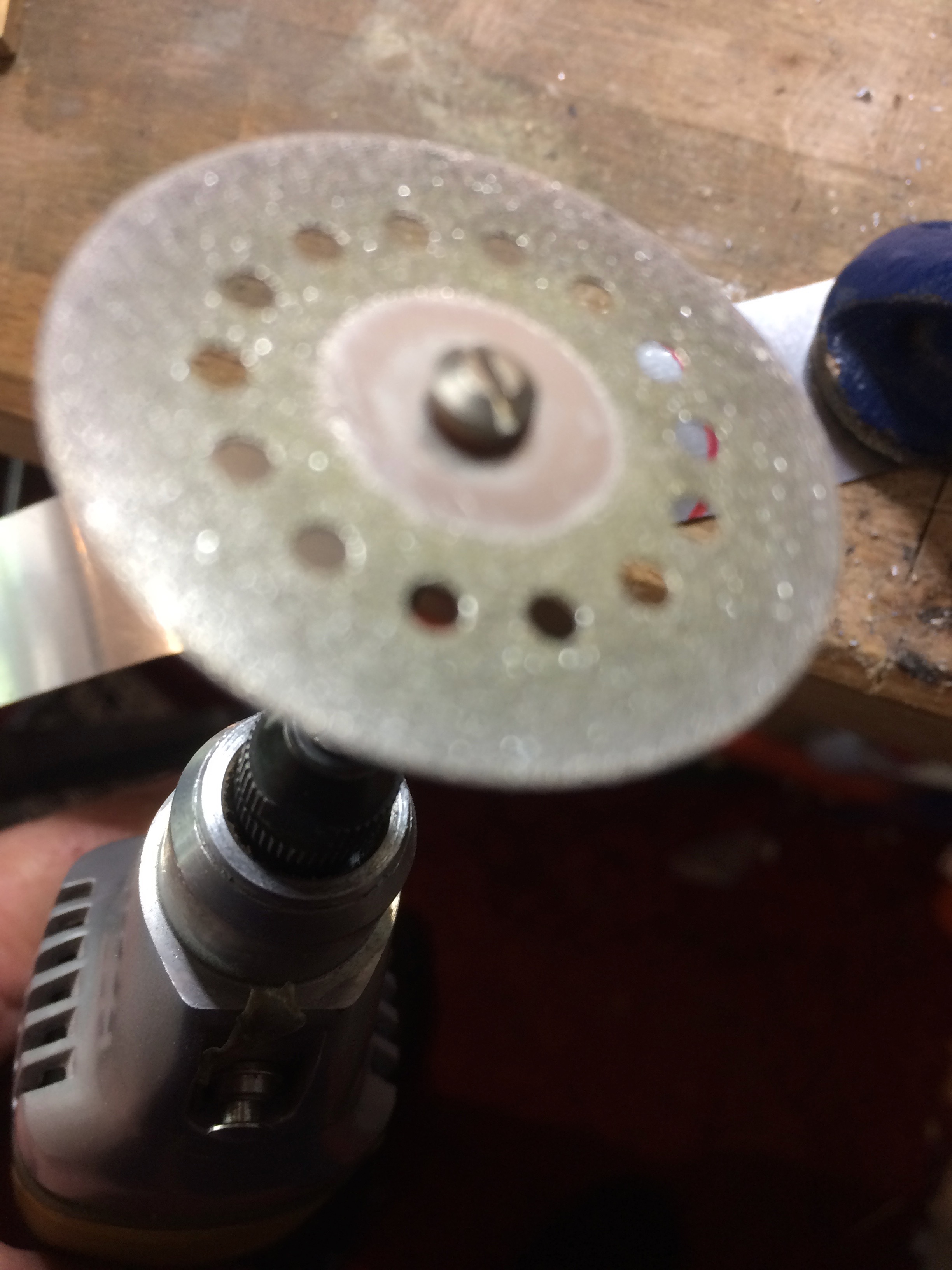

Ok here's the follow up of re-sizing a mainspring. I could not get the correct length vs. the strength so I purchased a longer spring.To double check i was cutting the new spring to the correct size I measured the old one with a piece of string. I then marked the new spring and cut with a diamond wheel. However when I tried to drill the end hole the drill just would not cut so I softened the metal with heat. After drilling the holes I finished with some filling. However I got a unwanted bend just before where it hooks and I suppose because the metal was now soft I could not remedy this so I had to cut off another inch and do the same process again and this time it worked treat. In future if possible I will see if I can purchase a diamond drill to make the hole. See some pics of the procedure.

Diamond wheel used for the cutting

Holes drilled
Almost ready just a little more filing.
