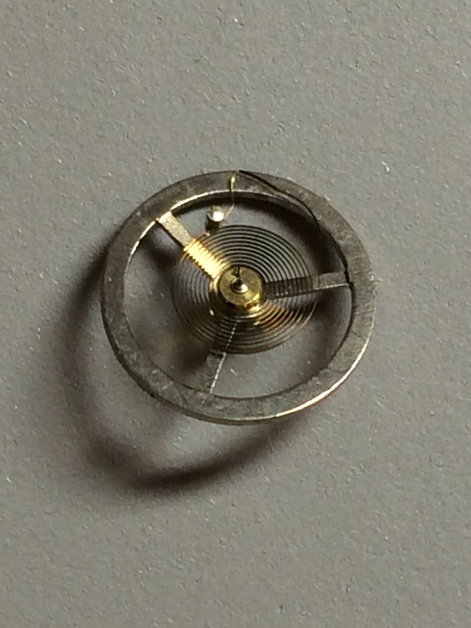

I think I know the answer to this question already, but wanted to check with those more experienced than me. I have worked on a few watches of late with the hair spring formed (or did formed) as in the photo below. I usually straighten them into the regular hairspring form, but it just dawned on me maybe they should be like this? Could anyone please confirm that this formation isn’t normal?
Looks like someone has adjusted the regulator with the spring stuck between the curb pins. Quite common. Needs to be corrected.
I can't imagine that's anywhere near normal, I agree with [mention=1848]rodabod[/mention], needs work...
Thanks for confirming guys. I had very strong suspicion it wasn’t supposed to be like that, and thanks for suggesting how it probably happened. Ironically I’ve seen 3 like this in a short period of time and just had a niggle that maybe it was by design. Once again for clarifying. Kind regards Deggsie
