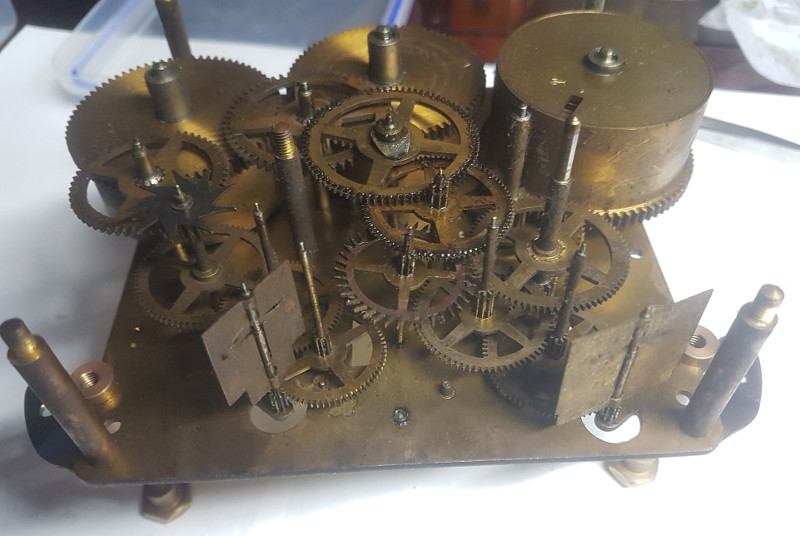

I need to service a Westminster clock for one of my School projects.
I've only just finished stripping it down and cleaned it so I can now see what needs doing, and thought people here would enjoy some 'before photos' and hopefully in the not too distant fusture I will be able to provide some 'after' photos.
Fairly standard looking clock, it is a Hemle, but just stamped 'Foreign' on it.
I'm pretty confident of the manufacture date.
Now remember if it doesn't run, just add more oil.....
Hermle4.jpg.ab4a67771bc73b121365596b3ed45fb6.jpgHermle4.jpg.ab4a67771bc73b121365596b3ed45fb6.jpg
When I got the barrels open the mainsprings were completely dry, but there was oil on everything else. I'm wondering if the movement got the 'Dunk the complete movement in petrol, dry off and just oil what you can get to treatment' at some point in the past.
Pretty much all of the pivots need polishing, one pivot hole has punching up on it, although atleast half of the pivot holes will need bushing as does atleast one mainspring barrel and the anchor needs the pallets refacing. Lots of work but hopefully all achievable although the pallet refacing with offcuts of mainspring is something I've never done before.

Bog standard chime. You need a mainspring winder for those springs. Any chance of a look at the pallets, it isn’t very often the pallets of these clocks need to be re-faced.
Pallets are heavily warn.
I have had it confirmed by both my lectuers they need refacing. Im at work so dont have the photos handy.

The clock is now ticking and chiming, just need to finish regulating it.
I won't go through everything I did, but just show what I think are the more interesting things.
Firstly the Chiming barrel arbor hole had worn oval and need bushing.
First the barrel was set up on my large lathe and centered using a dial test indicatorcentering.jpg.110286f5eade3520d3fd401a99cb3d2f.jpg
It was then drilled out to 10mm and the hole was measured to ensure it was exact
A brass clock bush tube was selected that was 11.4mm outside diameter and 8mm inside diameter.
The thickness of the base of the barrel was measured and the height of the lip of the bush was machined 0.2mm taller than the thickness of the base of the barrel and the diameter was machined down to 10.05 to be a friction fit inside the barrel. A 1mm lip was left to sit on the outside of the barrel as this would not impact end shake and gave added strength.
The bush was then transferred to the watchmakers lathe to clean up and add a leading edge chamfer to make it easier to fit. Finally it was pressed into the barrel using an arbour press.
Once the mainspring arbor had been polished the bush was then broached to size using clockmakers broaches.
I needed to polish a number of pivots that were all 0.8mm in diameter. I know some people can just hold the wheel in a pin vice and using a pivot file and a block of wood polish the pivot, but I'm not that good.
I got some bar stock that fitted the tailstock on my watchmakers lathe and drilled it 0.8mm. I then turned a taper to the end and transferred it to my mill and milled just over half way through the bar so just slightly less than half of the 0.8mm hole was left.
I then set up my watchmakers lathe as a turns and using a pulley that I had made previously which has 3 screws 120 degrees apart screwed it onto the arbor and using a bamboo rod and finishing line made my bow so I could use my lathe as an oversized jacot tool.
The pivot was filed with a pivot file, finished with a triangle Arkansas stone and burnished with a pivot bunisher.
Hope this is of interest to some people.
