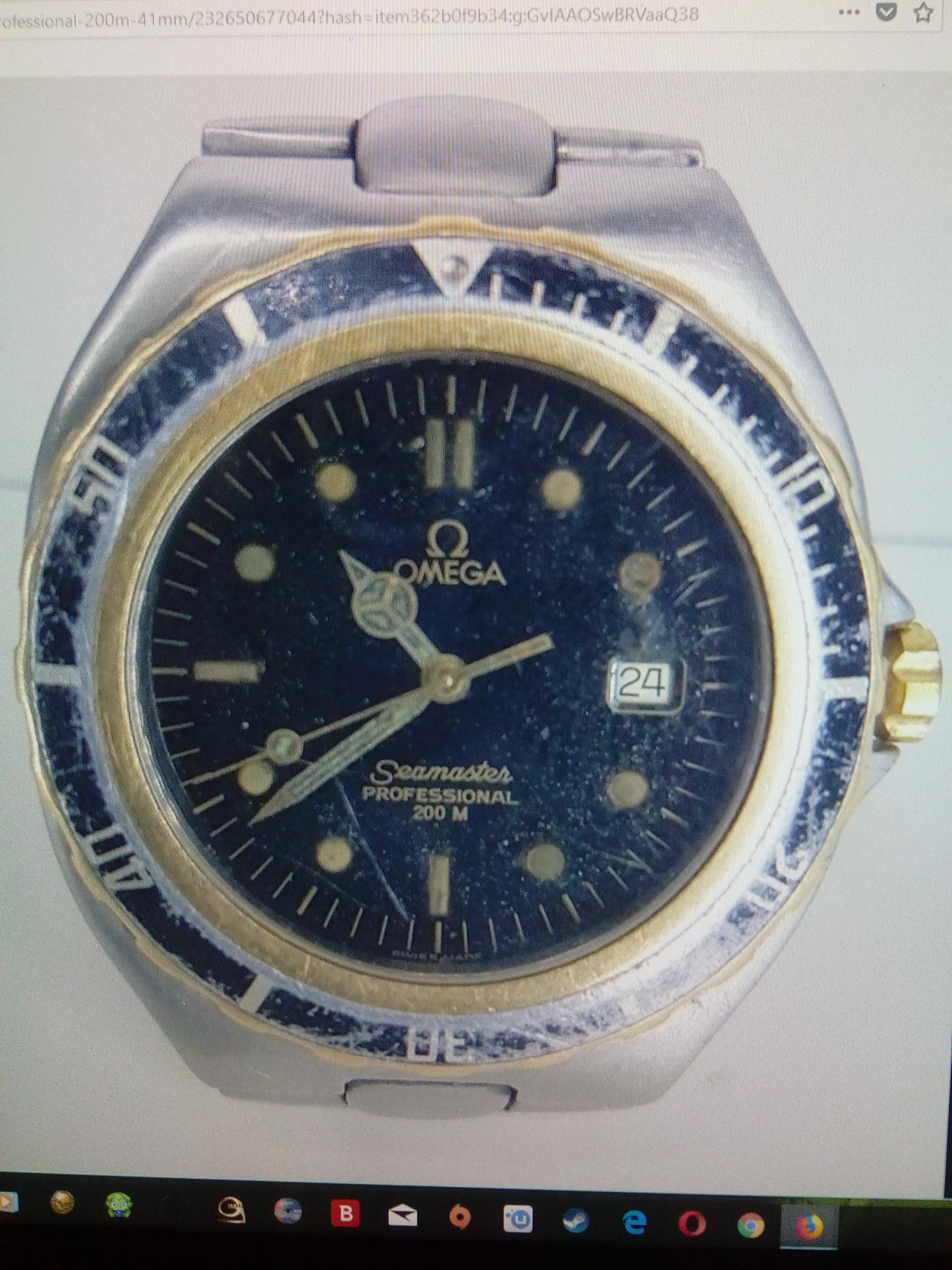

Do you think so? To start, your "Seamaster" has a tachymeter bezel which is never used on a diver or non-chrono watch. Then lack of any thickness in the indices, poor lettering, thick date font. On the back the lettering is filled black but it shouldn't, plus no circular finishing. etc. Compare to the picture below from a current ebay listing, about which I don't guarantee authenticity either.

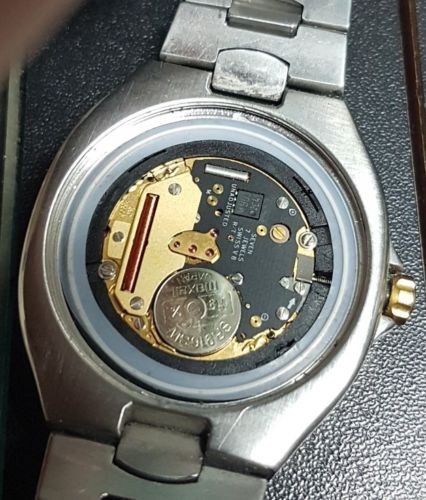

If you want another opinion you can post on WUS in the Omega section, but I suggest you take better pictures, and with the case back removed.

But the inside movement are Omega I read it on it. I will send the picture soon I got the watch.
Anyway... I bought from ebay another old Omega Seamaster Professional to replace the movement.
Here the photos of theis watch.

Hello Thomas please pm me when you get the watch back and I will be happy to guide you through the procedure to replace the quartz movement and hands. With regard to removing the winding stem and afterwards the hands, I would suggest you procure the following which are readily available off eBay (just check origin and associated delivery date first or you may be in for a long wait): -
Brass watch tweezers
Watch movement cushion
Hand removal levers (pair)
Hand re-fitting tool
Watch makers screwdriver set (budget / low cost unless you intent to make this a future hobby)
Adjustable watch back removal tool
Clean table, some time and a patient mood.
Sadly, I cannot comment on authenticity of your watch - but would tend to think you would have been advised if the watch was not original?
Regards Deggsy

I put it on a compact demagnetiser, then the watch refonction normal like a new watch!
Thanks for your help.
Wishing Success
It s kind of Magic
This is my first ever repair without opening the watch!
