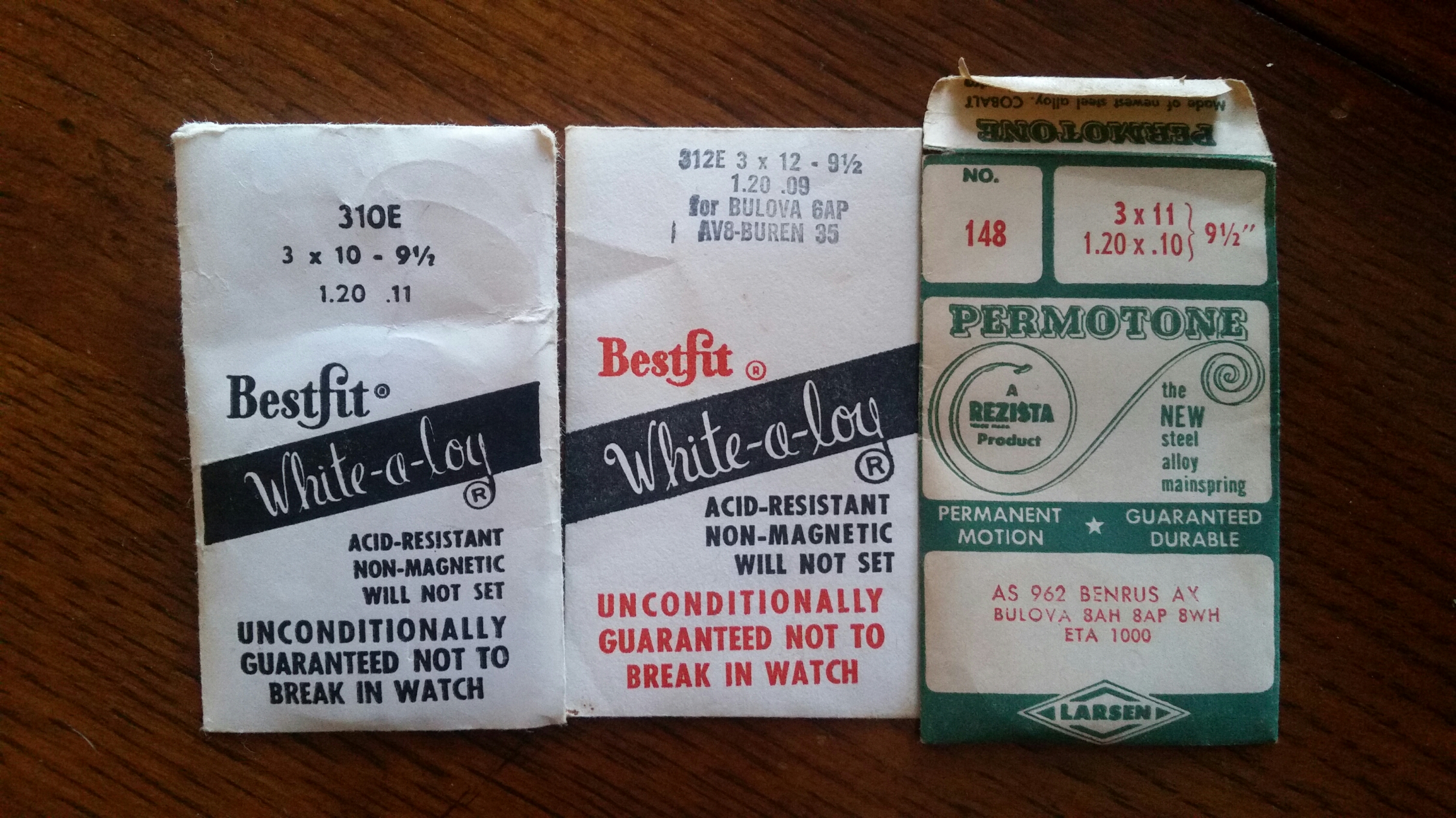

If you measure the old spring, height, thickness, length, and what type of bridle I'll have a look at my stock, I have a ton of NOS watch main springs.
This is what I have and you're welcome to them if you want. The best match is the permotone, just a half inch shorter but otherwise correct, and it's alloy so no rust

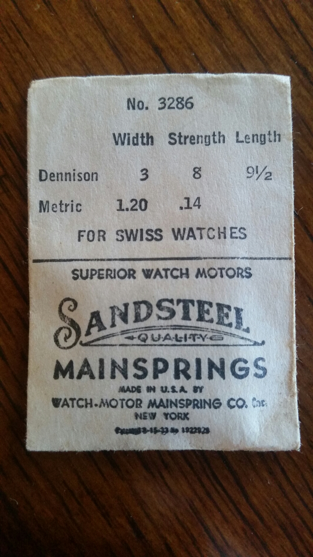

Well it would help if I looked for the correct strength, for some reason I thought it was .10, I'll look again, just my memory letting me down again.
The Bestfit 310E is pretty close at 1.2x.11x9.5
Edited by khunter
This is the only other one I have, it's slightly stronger and only 1/2" shorter so barrel space shouldn't be a problem. It is not an alloy spring though, brown/blue steel.
Edited by khunter
