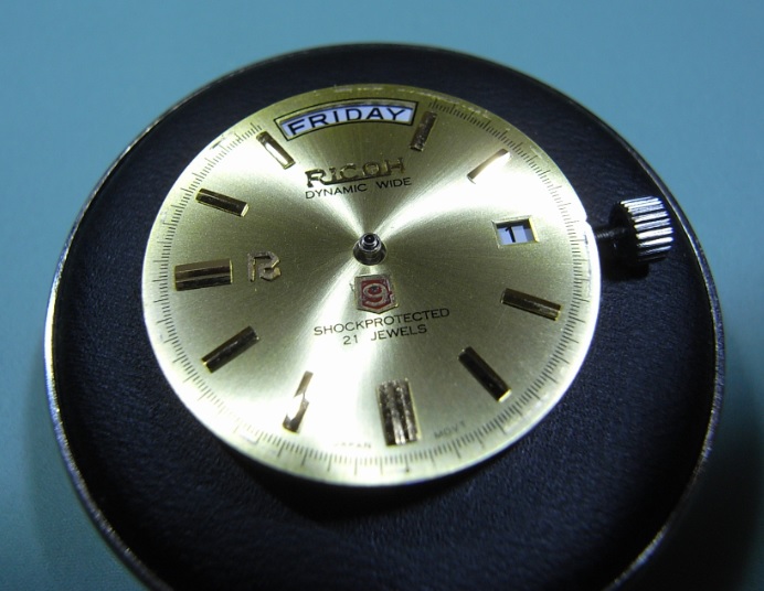

New watch to practice on came in the mail today.
It was a cheapie on Fleabay; but has a Day/Date Complication, with a pusher advance for the date, that I thought would be a nice advancement in my training.

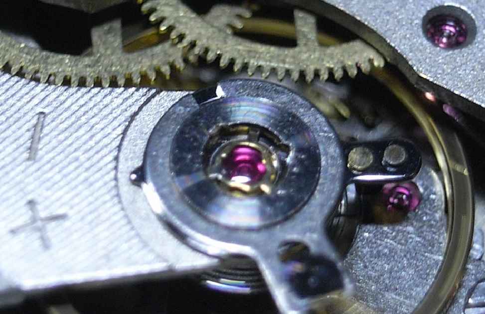

There was two other components in servicing this watch I need practice on: springs and incablocs ... and this movement has them in spades!  And to stretch myself further I choose this movement because it uses a copy of the Seiko DiaShock System, this time with a more complicated three prong keeper; as apposed to the dual prong keeper in the 7S26A Movement I completed previously.

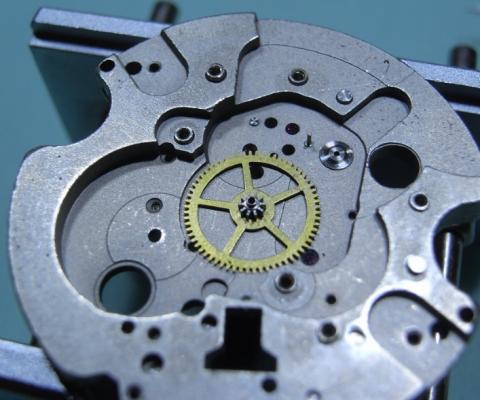

And lastly remove the Centre Wheel

Reassembly is just a complete reverse of the previous procedure.  The only difference is the incablocs, as they are a DiaShock System, and the Keepers are VERY small indeed.
As shown the 7S26A Walkthrough, use a plastic covered Paperclip as a special tool to hold the Keeper in place while your remove and install.

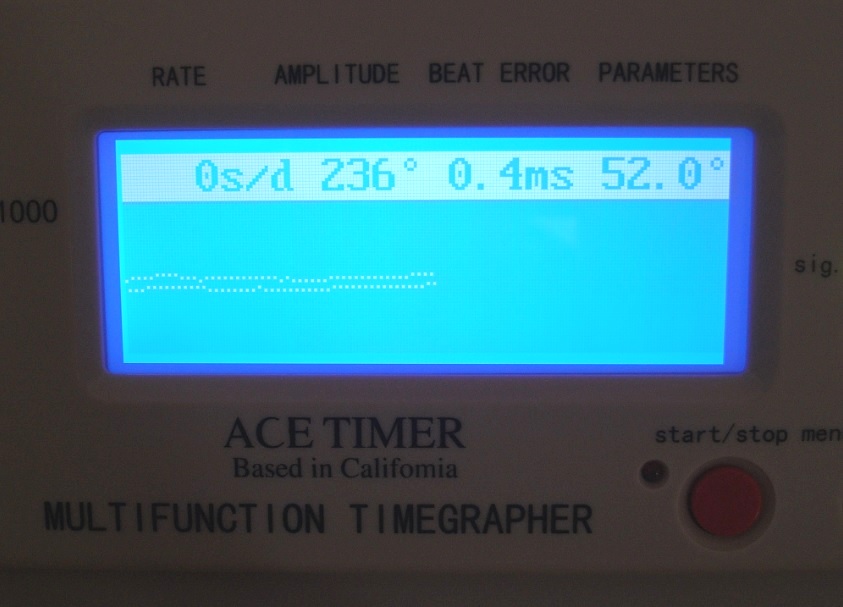

nice one... was it running on arrival? Would have been nice to compare the timer tracks before and after.

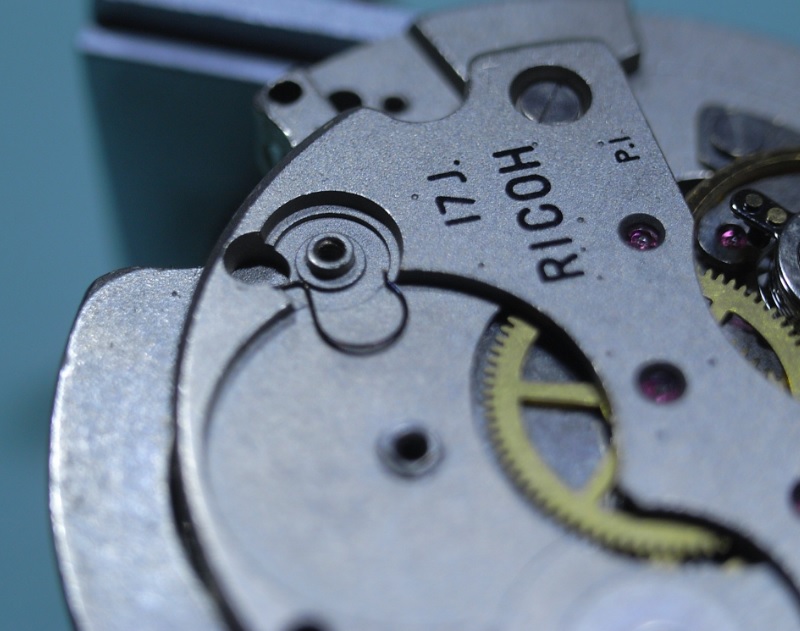

Just curious as to why the dial says 21 jewel yet the movement says 17 jewel.

Good point Anil.
Yeah it was running.  From memory it was -25 to -30s/d (wavered a lot; but not a complete splatter pattern), and Beat Error was 3.2ms.
Next time I'll start with a picture of the starting condition of the movement on the Timegrapher.
