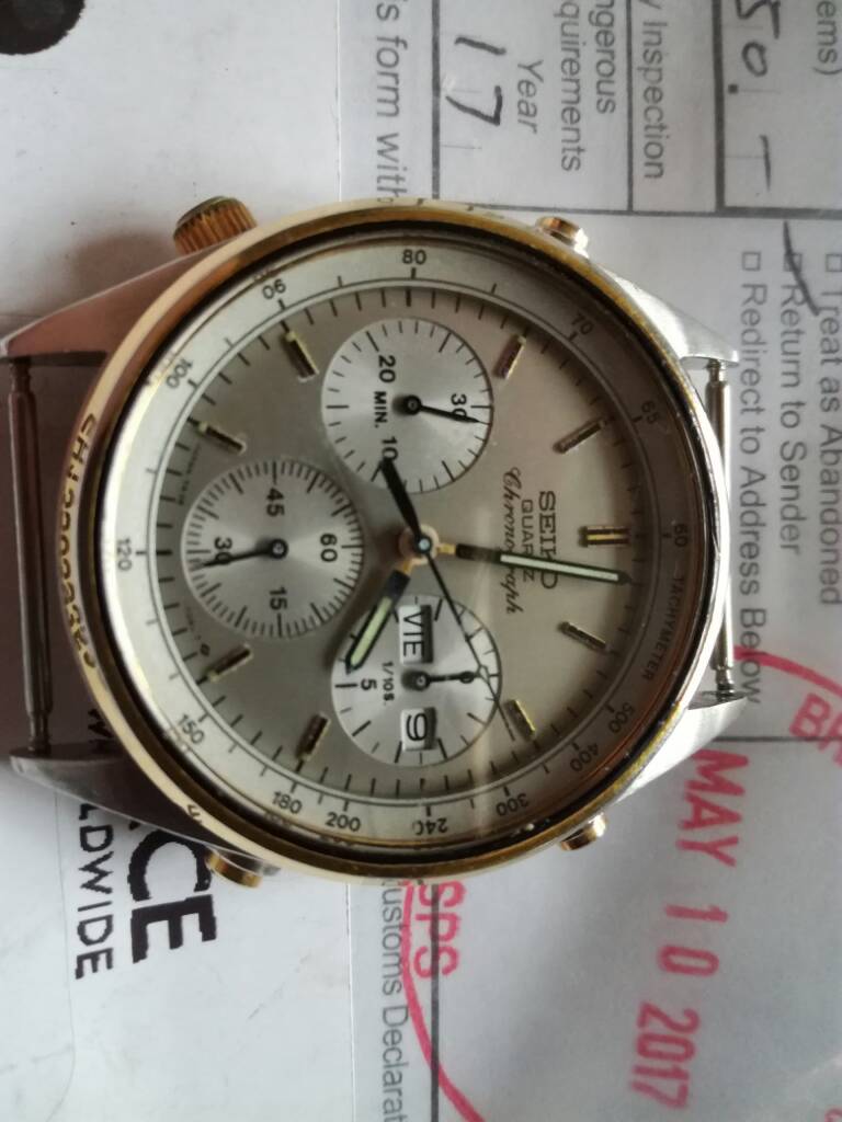

Well, bad news and good news.
The bad
But the good news is a VERY generous member on another forum sent me a working donor.
Only thing is.... I stuck it on a brown leather strap with gold buckle and can't bring myself to pull the movement to transplant into the first one [emoji4]
Now all I need is a working donor with a trashed case [emoji6]

That IS bad news and Very good news , and a little something in-between....I think .
Curious , Is the dial seated properly?  In the pic It seems to be lifted a bit from 10 to 3 . I have had similar circumstances where the dial wasn't seated all the way caused by the dial feet not being all the way down . I loosened the dial foot screw and was able to better seat the dial....sometimes .
Never noticed but I'll take a closer look. Might just be the angle and that shadow but we'll see.
Sent from my Honor 5c
OK , more good news..... Looks like you may have to zero out the minute subdial .
For that, it will need a case clean and rebuild with gaskets first. Will be ordering a load soon for this and 6 or 7 other watches.
