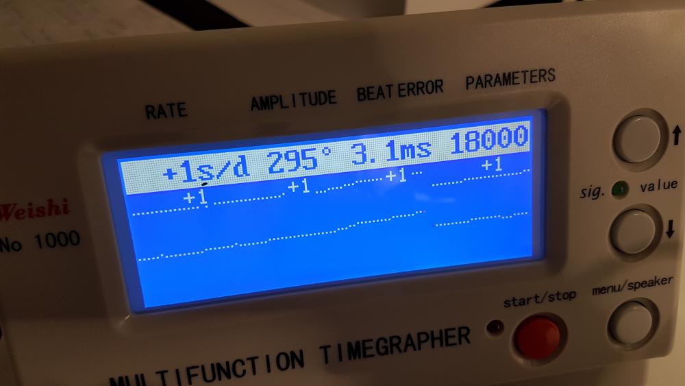

Hello again!!
Like I said earlier, I thought I had fixed it, but after running good for 48 hours, I just found out that it had gained 30 minutes out of the blue. And then when I opened it, I could see that the spring was together in one place. After I have had them apart I got this on the nice timeprapher display…..
So Im asking, Is there anything I can do to prevent this for happening again??

Usually this would indicate that either the hairspring is magnetized or has oil or some other contaminant that causes the coils to stick together.
Solution would either be to demagnetize or clean, or maybe both. I use Renata Essence, but hairspring degreasing fluid can't be shipped by air, so if you don't have any you will need to find a local source. Naptha or lighter fuel followed by isopropyl alcohol might be your best alternative if you can't find any. Demagnetizers can be had from the usual sources... pay your money and take your pick from a few £'s upwards.

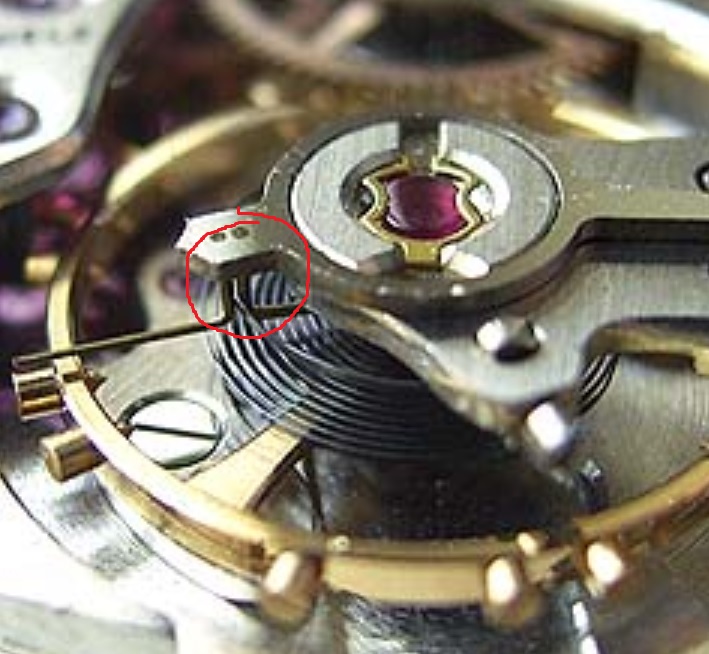

So I have changes it into the balance bridge, but when I tried it after it runs like -967 sek/d late. So I try to regulate it, but it seems not have any affect when I move the regulator. Then I see the that the sort of holder for the balance( see photo with red markings) is not holding the sping very tight. How tight should this be?   How to tigthen it?
That doesn't need to that tight. They are just there to hold the hairspring out so you can regulate the deviation . Have you adjusted the beat error? If not that has to be adjusted first.

Another thing...if this doesn't need to be tight , how do you shorten the spring for faster speed?
The gap between the regulator pins should normally be just greater than the thickness of the hairspring, but I doubt this is your problem here.
When you say you changed the hairspring, where did you get the new one from? Did it come from another old balance or from a new balance? Either way the hairspring will need to be matched to the balance wheel, and with an overcoil spring that is somewhat harder than with a flat spring.  I doubt you will have enough adjustment on the regulator to correct the error you have. Your timegrapher will likely only record up to 999 sec/day error, so you may be worse than that, but you will need to adjust the pinning point to shorten the spring. This will also likely mean the overcoil is in the wrong place, which is an advanced problem to fix. Do you have the balance that matches your new hairspring?

Hello Stuart;
Thanks for helping, the photo is for illustration, its not mine movement. But the gap is pretty much the same.If we start with beginning, the watch did not go at all. So I took it apart and cleaned it like I always do:
1) I let the parts spin in white spirit for ten minutes (turpentine substitute, petroleum spirits, solvent naphtha (petroleum)
2) Then I spin for 10 minutes in methylated spirit
3) Then I finish with a 1 minute spin in isopropyl alcohol
What you think of this cleaning method?
Put it together and saw that is was very fast, saw also that the balance spring was sticky, so I demagnetized, and tried, but the same. Then I took and cleaned once more in isopropyl alcohol. And while it was drying, I pushed it out on the floor, and it was all tangled up. Shame on me, but thats life...
While I was working with this I also saw that the beat error was like 3,1 ms.
So I got hold of a spring from this company http://www.urdelar.se I don't remember what it said on the web site, this was the only one they had, and the photon taken away from the web site. But this spring is coming from another balance wheel.
I thought as well I could use only the spring, because. I had to set the bear error right as well, by setting the spring on the staff aligned with the pallet fork center.
So I did, put up balance wheel onto the bearing, made two marks on the balance wheel, and one for the pinning point. Mounted the spring, and mounted in to the watch...
And here we are...
