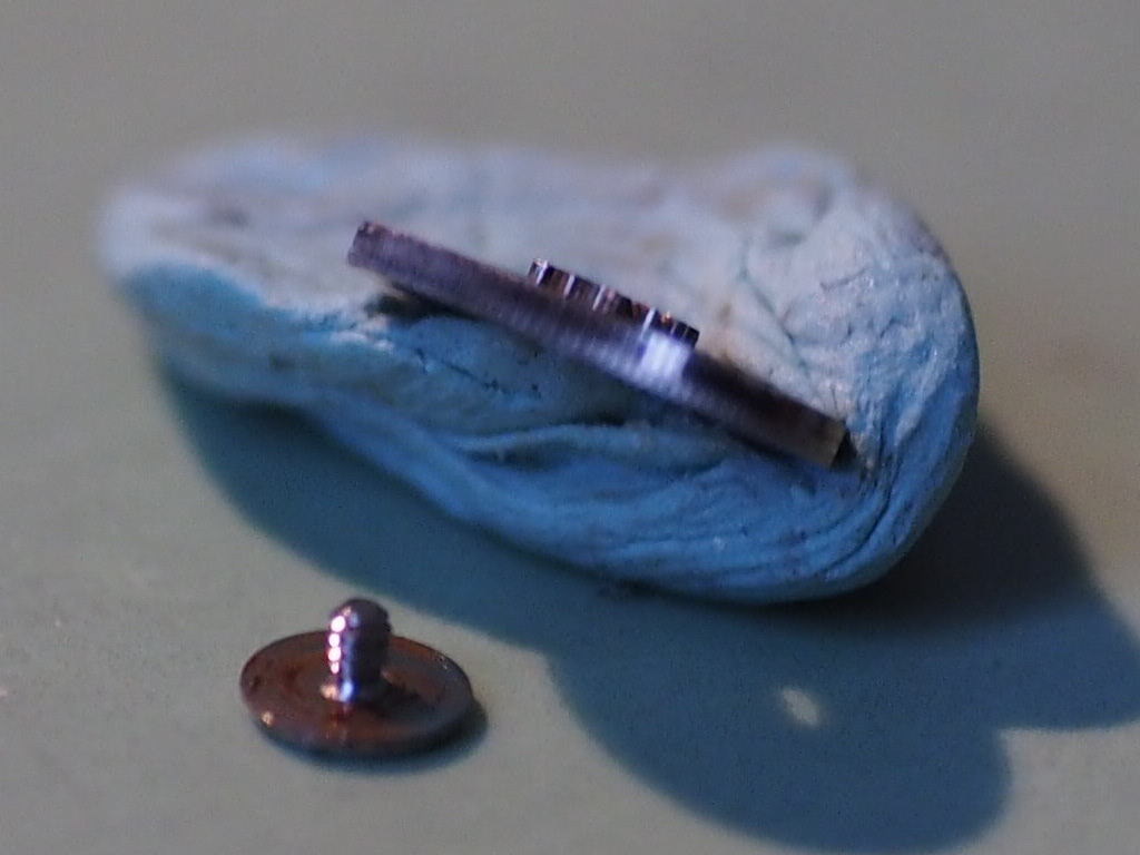

Much better to always check everything when buying a Seiko from the Philippines :mellow:
No surprise my buyer returned it as it wasn't winding.
Cousins may be out of that part, so good luck fixing it....unless it is a different movement from the 7S family....Let us know how you fared.

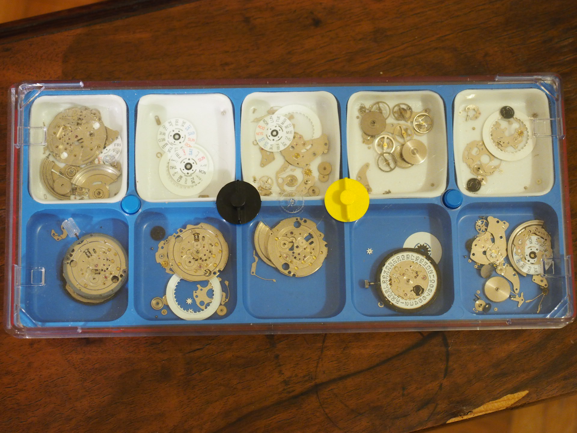

But something is still wrong as it doesn't fully wind.

Slipping mainspring? That is why your amp is low? Didn't you have a problem with that also?
You probably already checked the pawl lever for wear (either the hole or the claws), "tension" (they may open), and/or right/correct side installation. If that's the case, I would then venture checking if the mainspring is skipping or the hook is not doing a good job (worn)...at least those are the areas where I would look first.
