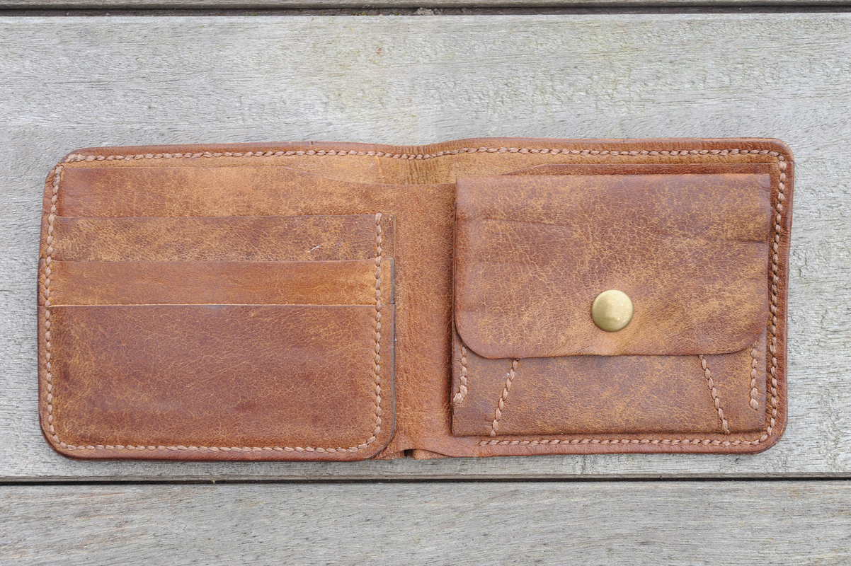

Hi Bob........ I didn't want to show it. It has too many flaws; it's the wrong leather (too thin, too soft and therefore the wallet comes out of shape), it has stitch flaws and design flaws, but the good news is that I learned a tremendous lot of it. I'm searching for the recommended leather (I deviated from the recommended :( ) and will add additional strips to make it more solid all around.
Not everything can be perfect the first time, and since you asked .......... here it is;
It's a bifold wallet with on the left side 3x credit-card pockets, and on the right side a coin-pouch. Behind, along the whole length of the wallet, a banknote pocket which will fit any note currently world-wide in use.
Even though not too bad for my first attempt, there is for sure room for improvement ;)
Not for nothing that it takes years to perfect leathercraft skills ...
