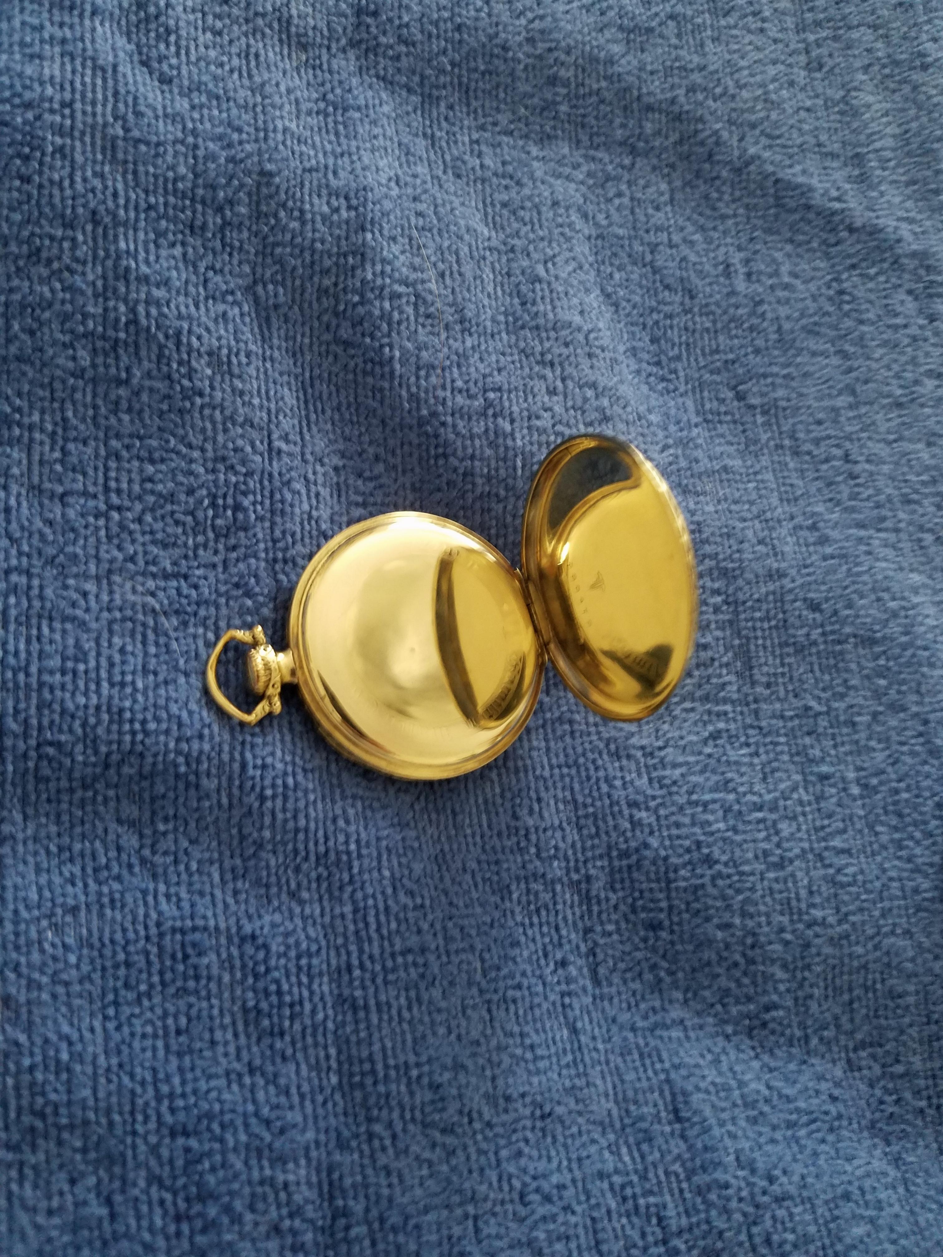

This Hamilton 912 is project I recently completed in May. The movement just needed a good cleaning. The dial was a mess & the case had a lot of dents to remove on the back.I broke out the Dremel to remove the many small scratches . The crystal was badly scratched and plastic, installed a new glass nos crystal.

To remove dents in a case isn't difficult, it just requires patience. Go to your Hardware store and by som nice Ash dowels. Cut them down to usable  lengths 4 to six inches . Round off the ends of the  dowels into smooth shapes sort of like a baseball bat. Smooth the end down until its very smooth so you don't do any damage to case.
Now using only your hands push the dowel down on a dent & twist  over and over again. soon you will notice it is starting to go away. As I said slowly and carefully Twist Push. Keep checking to see you are not doing damage."(NO HAMMER" just kneading.
You can experiment with different shapes and sizes. o see what works best for you. I have one with a pad on one end to keep from hurting my palm. Also make sure the case is on a hard smooth surface or you will engrave whats on that surface into your watch case. I have had great results doing it on four watches including a very small ladies Elgin Pocket watch.
