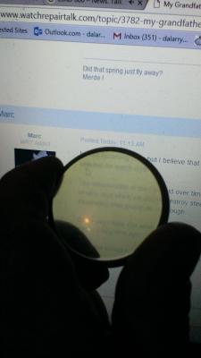

I could be wrong here but I believe that the issue with old plastic watch crystals off gassing causing corrosion is specific to the very old use of celluloid for watch crystals.
The deterioration of the celluloid over time causes the crystal to yellow, and the release of compounds from the celluloid can cause the precipitation of nitric acid which will quickly destroy steel watch hands and will almost certainly damage painted or printed dials.
Enamelled dials should be ok though.
Either way I think you would be very hard pushed to find a supply of celluloid crystals any where these days as celluloid was dropped in favour of acrylic a long time ago.
The issue should not occur with acrylic as it is a much more stable plastic.
Marc is absolutely correct re: celluloid versus acrylic.
i do however run across them very often as my interests lay in antique pocket watches.
attached is a pic of a yellowed crystal from a watch i picked up a few weeks ago at a flea market.
the owner thought it was a "tinted" crystal.
