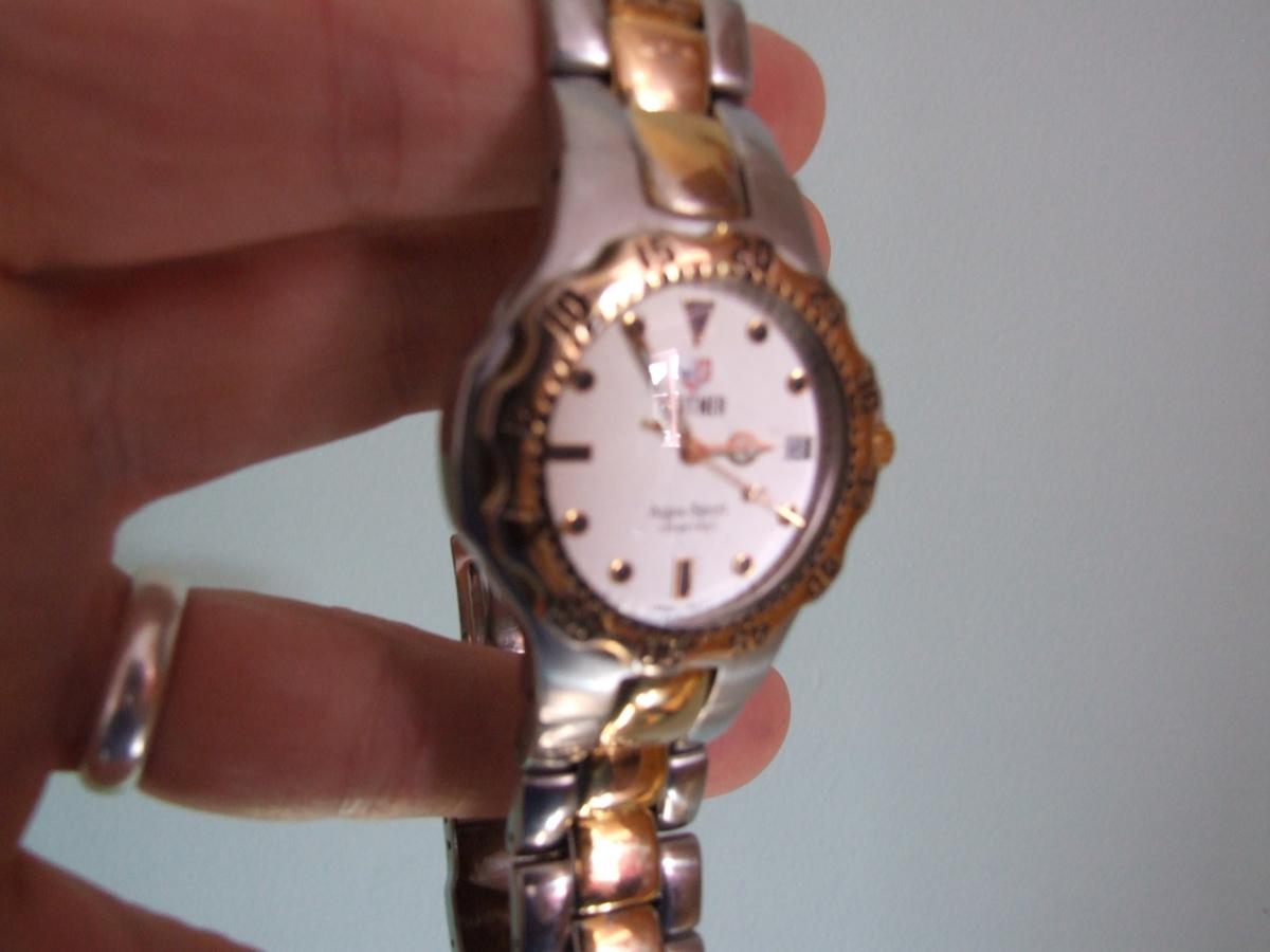

Thank you, you are amazing! Would you also be able to help with a further enquiry? This is also to do with a Zeitner watch, but this one is the Aquasport z2000g.i need to replace the movement, which says Rondo, but there doesn't appear to be any numbers.
If you could help that would brilliant

If you send a picture of the movement and the watch dial it will help a lot. If the watch has only the regular hands (hours, minutes and second) in addition to the date, I will venture it is a Ronda 515. Then you will have to measure it anyway because it comes in different heights and make sure the date is in the right place (some come with the date at 6) also they come in a 24 hrs version...all that has to be considered.
The number of the movement is usually on the edge of the black plastic that makes the "main" plate.

Hi, I have attached two photos of the watch, which does have a calendar. Still can't find the model number of the movement even after checking on and beneath the plastic ring; all I can find is the word RONDO.
Thanks again for any help - very much appreciated

Wow, you are the maestro! I found the writing which was indeed very tiny and nearly worn away. It's actually 715 (the 5 jewel version) I would never have found out without your help.
