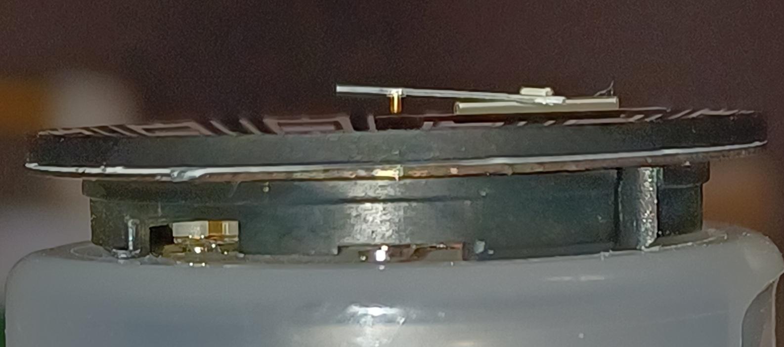

Ok @mbwatch I think I've addressed the end shake / pallet bridge issue. It looks like I may have installed the lower hole jewel upside down. Talk about a rookie mistake! It's so darn hard to tell the difference, even with taking photos. Anyway, now it seems like my end shake is reduced and the balance spins freely. So now I need to realign the impulse jewel. Can you refresh my memory here? Should I just take the hairspring off and rotate it in the direction to move the impulse jewel (i.e., rotate hairspring one way, impulse jewel orientation will move the other way relative to it).
Agree with Neven, roller table rotating out of true alters lift angle which follows an oscilatory path , that in turn changes the impulse delivered to oscilator at its TDC.
It must be very loose then 😲 I bought some brass shim sheet 0.001", 0.002", 0.003" & 0.005". Useful stuff. You can find assorted packs on ebay
